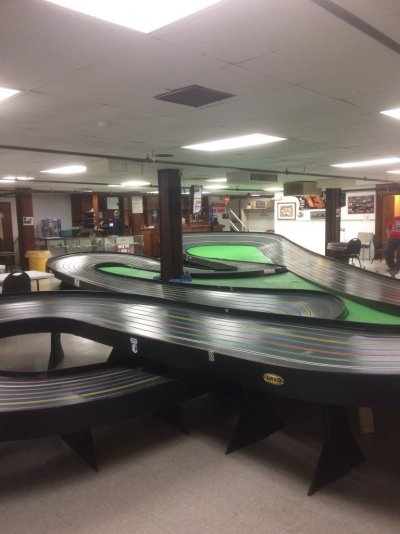

Looks like that track is for sale,and they want $2,000.00 for it.
Scroll down a couple posts to find it
no freaking kidding where do you think I got pic I ran across it for sale the night before you made this post and thought that is a good size do not know why but save it to my saved so I did then what do you know the thread came up and thought had to post that big ******* https://www.facebook.com/marketplac...8/?hoisted=false&ref=saved&referral_code=null

It needs some work,but it's probably not a bad buy,if you have the room for it.
Dan is pretty the premier slot car timing system supplier,i have his computor timing/lap counter set-up on my track.

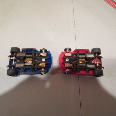

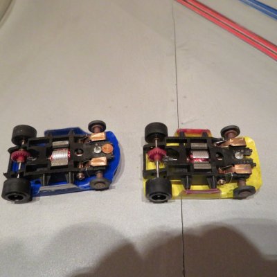

This is one of the higher end class of cars,full roller bearing custom armatures/steel gears/polymer mags/custom chassis etc.
The next pic is the class i prefer,same basic build as the faster cars,but with no traction mags,so a lot harder car to drive,they act more like a 1/32 car,you can hang the rear end out on a curve,lol

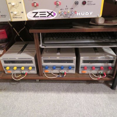

(1) 0-30V 10 amp power supply per lane.

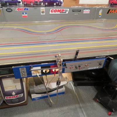

Drivers station and controller

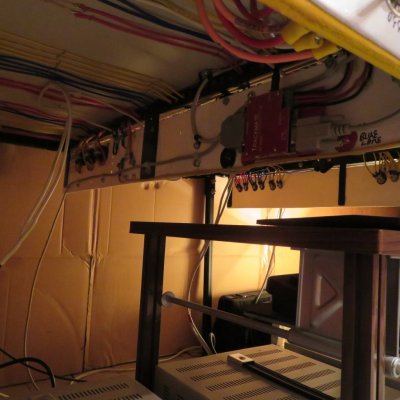

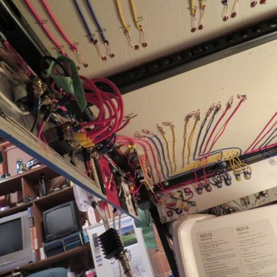

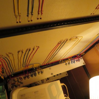

Wiring on the back of the drivers stations,along with some of the wiring going through the bottom up to the rails,to power the cars.

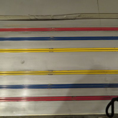

How i did my power taps,the 14G solid wire that comes up from the bottom,is then soldered to the sides of the rails,each lane has 14 power taps,so there's no voltage drop the full length of the track.

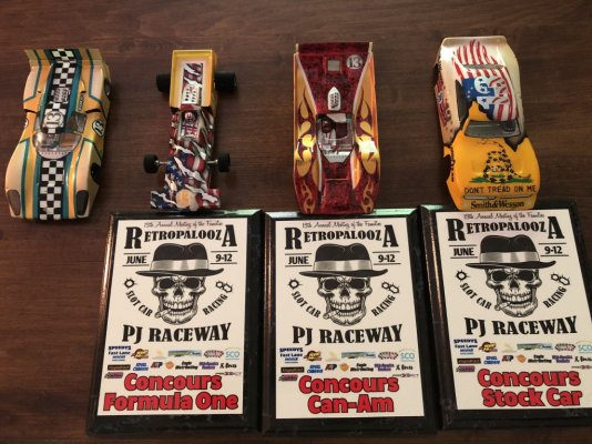

I race 1/24 scale at my local track and run a monthly series at tracks around New England. Done this for most of my life but what I enjoy is painting the clear bodies with airbrush and hav won many concours awards. It’s a great hobby but getting the younger generation into it has been an issue.4DD69673-6810-43E3-81D3-F0C540E44F24.jpeg

Wow is all i got,lol. Those look wicked Rebel,you have some airbrush talents.
