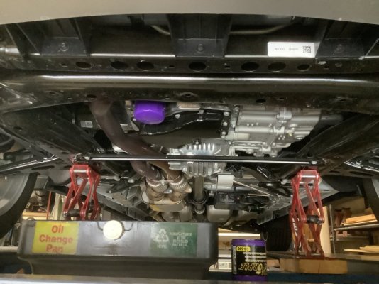

I got the old gasket (tray) out and cleaned up all the mating surfaces.
I’m working with the front end up @ 12 -14 inches or so.
I’ve seen videos where they drop the differential. I got everything in with a lot of difficulty. Used rtv sealant in the four corner areas.
I’ve read different specs online. 22-25 ft.lbs? What are the actual torque specs on the oil pan bolts?
I snapped one bolt on the shallow end of the pan. I’ve got a special paid of Japanese pliers that are designed to extract a broken bolt with as little As 1/16”. I have to remove all the bolts tomorrow, and extract that one bolt.
Again, I’ve been looking online for a complete set of oil pan mounting bolts. Again, Mopar wants to bend you over for every bolt!
Does anyone have a link to a complete set of bolts for these oil pans?
Also I removed the plastic clip that connects the cooler lines to the oil pan stud bolt. Can’t find the damn thing!
Does anyone have a part number for that as well?
Thanks!

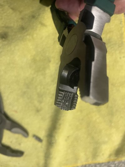

A friend of mine told me about these pliers years ago
They are made in Japan. And they have a specific design to extract any type of bolt or screw. With his little as 1/16 of an inch, these things will grab it and unscrew them.
It’s not a tool you use often but it’s priceless when you need it:

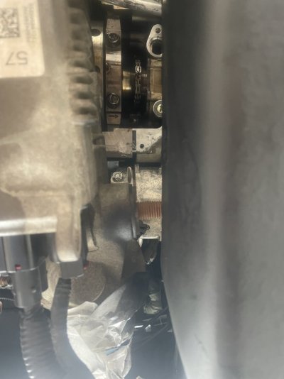

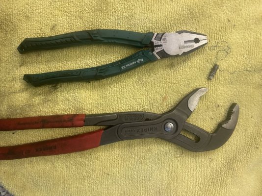

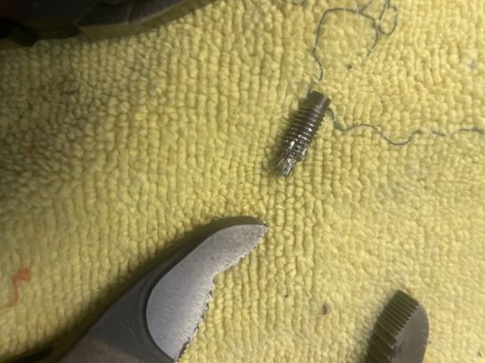

I had to drop the oil pan and gasket/housing
The engineer “nejisaurus” pliers are worth their weight in gold. They are designed to remove any broken bolts or screws.
In this case the broken oil pan bolt was above the steering rack mechanism. And close to the welded cross frame. I had to remove one bolt completely and loosen the other one mostly
I had @ 1/32” turning area with the engineer pliers and the knipex channel locks clamped onto the handle . Occasionally spraying the bolt with Gibbs penetrating lubricant.
It took a long while, but it finally came out!
It’s amazing that three different people on three different YouTube videos told in 25 foot pounds. These ******* must’ve been thinking about the main drain plug.
Only have to looking around online. I found out it was 9 foot pounds. And the worst part about Mopar is you cannot buy a set of bolts. They want to charge a lot of money for each bolt.
I just have to go outside and tighten up the bolts through the cross frame to tighten up the steering rack
As I said before these engineer “nejisaurus” pliers are worth their weight in gold. It’s not something you use often, but it works!
