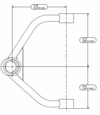

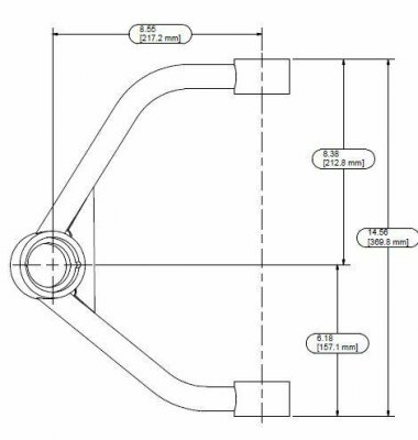

I'm putting a 3" lift on my 2014 Ram 1500 4X4. While shopping for control arms with the correct angle I noticed Rocky Mountain Suspension Products website lists a decent pair but their year range states 2009-2019. Do the 2019 upper control arms fit the 2014? Because I see a lot of ranges that go from 2011- 2017, 2009 to 2015, but have 2019 -2020 by themselves. What is the correct fitment range? For one, I want to order the right set and not have the truck tore down to find out the year range was listed incorrectly.
This info would also help as I have access to a set of 2019 heavy duty upper arms designed for 2-4" lifts and for a great price too. Thank you.

Rule of thumb, 2019 Classic 1500 are 4th gen trucks, and they're literally the same truck as a 2014, maybe different trans, pcm, etc, but in terms of suspension components they're pretty much the same thing. 2019 5th gen are different though and you should find those listed as 2019-2020 as you have noticed.
