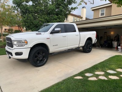

I have a 2017 Ram 2500 mega cab and put 35's on my stock wheels no level without any rubbing. When I got my aftermarket wheels, I put on a 2" thuren level because the offset of the new wheels caused the tires to rub.
my buddy has a 2019 ram 2500 crew cab with 35x12.50r18 on his stock wheels and NO LEVELING KIT. No rubbing, no clearance issues. He pulls a 33ft trailer weighing about 8K. From what he told me, his truck is in so much more control than the stock tires. He also has 4.10 gears.
