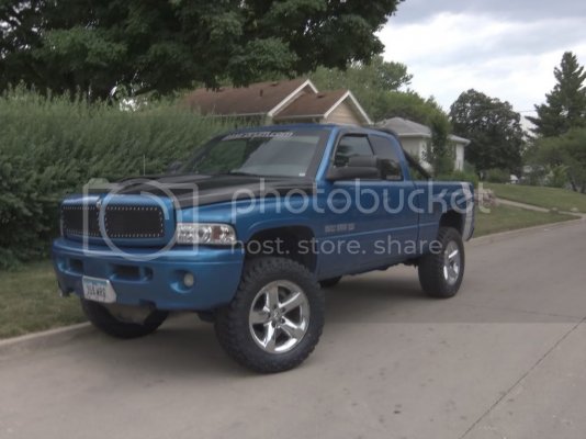

I run a 295/60/20 (I believe it's 34.6") I got room. I did have to remove my nerf bars (they were off a hummer and custom mounted anyways. I do rub a little on the fender liner when turning, but not much at all and thats at full lock.
