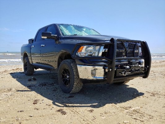

I am looking at trying to get a full replacement winch capable bumper for my 2018 Ram 1500.
I currently have a Westin brush guard and winch tray. It works but it is not what I want.
Now and do have a couple of requirements, 1) it needs to be less than or close to $2000. I'm not paying 4-5 grand for a bumper. 2) I do not want my truck to have a fat lip. Most of the winch bumpers I am finding have this ******** lip look. There is way more than enough room for the winch to fit within the frame.
I would consider the idea of one of the hidden winch plates from the company out of Canada, but I want a stouter front bumper as well with tow points etc.
Has anyone tried using one of the hidden winch plates with an aftermarket bumper that was not designed for a winch?
I am having a hard time finding what I am looking for. So, I implore the Ram community for some assistance.0c42c7486d9ae247e699eff4a7c39833.jpg
