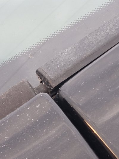

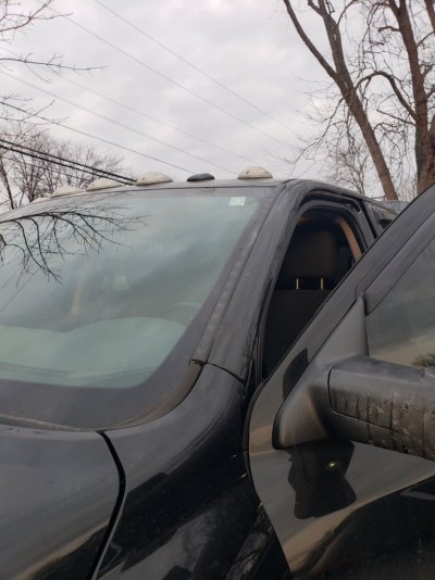

Found this this afternoon, both windshield side trim pieces have moved about 1/4 - 3/8 of an inch. Has anybody delt with this issue, if so what am I looking at repair wise ?

I havent seen them shift like that, but doesn't surprise me. 68297608AB & 68297609AB are the trim replacement parts. About $75 a piece. I've been thinking about replacing mine too due to the severe fading. You may need some new retaining clips too, 4389815AA. Four per side at about $3.50 each
That's for a 1500, may want to double check if it's the same for 2500

Should be, same cab. Need to figure out the cause of the shift....
I haven't pulled mine off to look at them yet, but I'd bet whatever holds them into place on yours has bent/broken. I think you can just pull them off or try to slide them back down.
