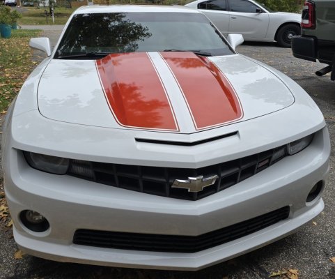

I still use steel wool and water. Cheaper for me.
Change your user name to Poorie_Poor. :D
I clay my vehicles anyway. Once clay is old, it becomes the glass clay. Once it's dried out and hard it becomes trash. Maybe $20-$30 every other year for clay and lubricant, mostly lubricant. I keep my stuff nice long term. 2011 Camaro (and 2021 PW peaking in at the edge). Camaro was just waxed in this photo, PW is "dirty" but still reflecting nicely.
