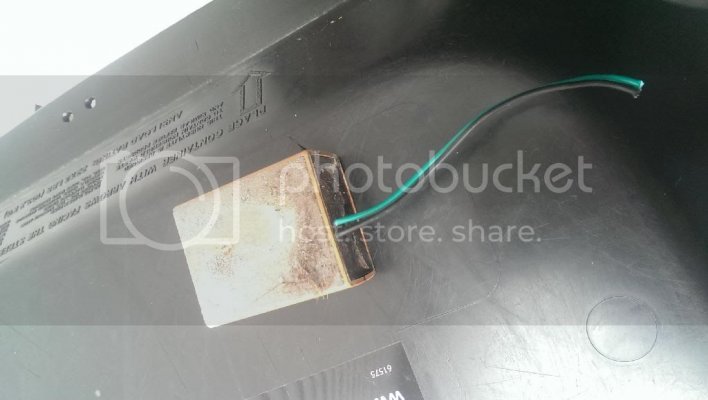

We ended up finding 2 shorts in the wiring going to the left taillight. Neither wire was broken all the way though, just the copper wire inside, so it was next to impossible to find. Once we fixed that, the taillight worked find, but we still got the fast flash on the turn signal, and ding with turn signal and brakes. I narrowed that down to the resistor in the led taillight itself. So today I cut out the old resistor and put in a new one... so far so good!
Here is the old crappy resistor cut out:
And the new resistor in its place (the yellow box):
I bought the resistor from superbrightleds.com for only a few bucks... so all in all, the entire fix was less than $20... but it was a HUGE headache.
