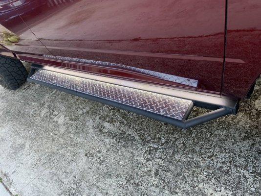

You could always use the footwell lights to power the puddle lights if you do not have footwell lights installed. I used the footwell lights to power my step lights on my truck.

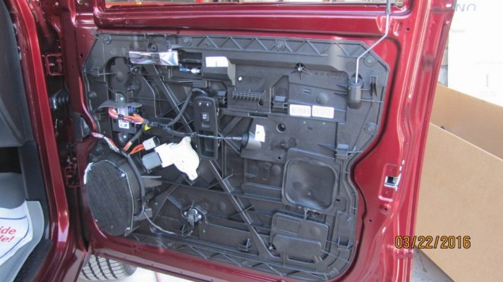

This is in the drivers door, there is another one in the passenger door
it controls all the mirror functions, it also controls the door lock functions
It likely works the window motors also
it is just above the speaker
