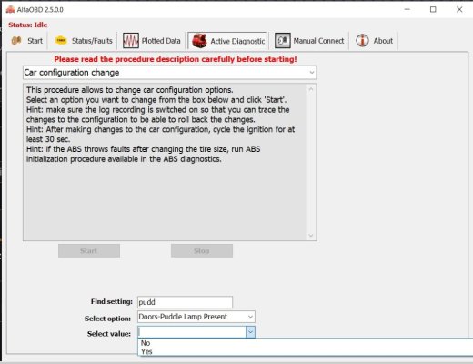

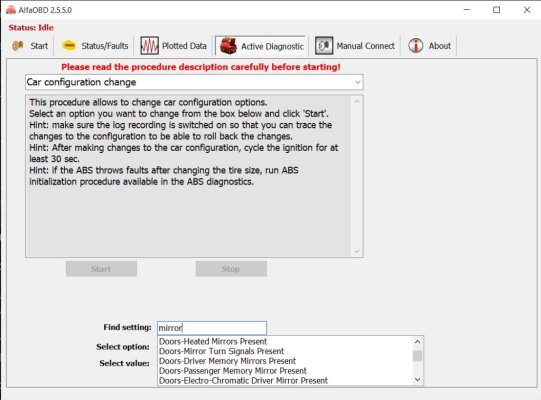

Late comment
Under the Body computer
Mirror turn signals- present
Mirror approach lights- present
with tow mirrors
Tow mirror- present
you will need new door modules to activate power folding.
