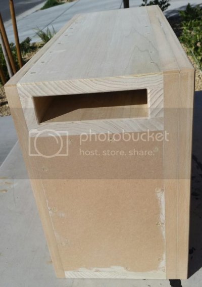

Some pics of the sub box:
Not finished but close. Figuring out how I want to secure the Sundown sub.....

to fasten the sub i would look into threaded inserts. that way if you have to remove the sub at all you dont keep putting more holes into the box.
Search Results for*threaded insert*at The Home Depot
why plywood for the port and mdf for the rest?
ok cool, will look into them :)
well sort of a lazy reason I suppose, all I had to build the box was a circular saw, a dremel, and a hand sander so I cheated a bit and used precut wood to establish the box width = less cuts.

Beautiful box. How do you plan on finishing it?
thanks man......so far I'm coating it with bondo.......going back and forth between, Linex coating and upholstery......still haven't decided.
