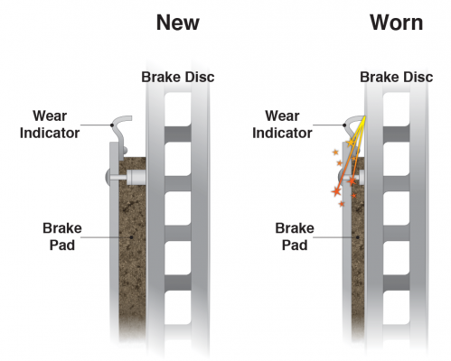

Always check to make sure wear clip is not grinding into rotor, can happen 30k miles or less many times depending on driver and weight of truck. It is designed to warn driver time to do pads.
Go to Ceramic like wagner oex, low dusting low noise. They say ceramic doesn't give as much friction as metallic brake pads, but mine grips better then oem as well.
