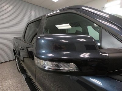

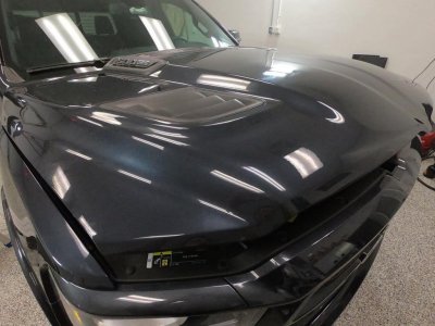

1D72A8A1-7E4D-4B82-B9B5-7605E62955AD.jpeg 05456C4D-C30E-4500-890B-B0C9E7F1BDDE.jpeg 4CD9CDFA-81B8-45A4-972C-4F8890BF9366.jpeg A5848968-2BBA-45A3-A774-191885DA80D0.jpeg 8EB461AE-CF0C-47AE-AA23-BF588CDA5FA1.jpeg In my opinion, this should be everyone’s first addition! 10 year warranty and self healing, can’t beat it!

$700 for the front bumper, grill, under the headlights, the piece between the grill and hood, 12” up the hood and the mirrors.

How does the line look where it stop in the hood? Said it did 12” up the hood. Curious how that line looks where it stops

The trick is to use the XPEL Sealant. It is clear in color and offers really good optical clarity. You do not want to use a colored wax on PPF or the seams will become very visible and you can stain the film. Alcohol on a Q Tip is recommended for removing any wax/sealant build up at the seams. The mirrors are two pieces of film.
