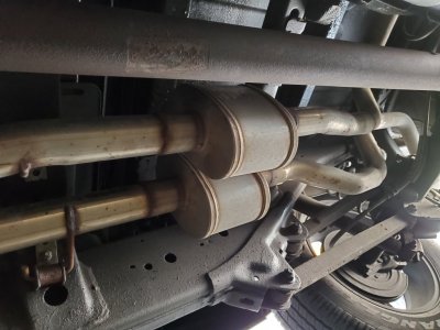

Hey guys. I bought the Magnaflow y pipe from Moes, think it’s 10778. It’s the 2 pipe 2 1/2” inch in and one 3” pipe out. Looks like the one I’ve seen guys use in similar situations. Looking under the truck and then looking at the pipe, I can’t envision where to cut it or how it’s going to fit. I did call a reputable exhaust shop near me and ask them about it, and they are willing to do the job, but never did one before so was no help. I have an appointment with the guy next week. I’m going to bring the pipe and would like to understand it myself so I can explain it to him so there are no issues. Anybody know or remember where and how the cut theirs to integrate this piece? And for anyone who did it, any difference in sound or performance? Thanks

Since posting this I found a pic on the forum of that exact piece installed. I thought you cut it at the y and this piece would somehow fit in its place but the more I look at the picture it looks like it was cut a little further toward the front of the truck and then a pipe was added to each of the pipes coming from the engine, then into the y which in turn connects to the rest of the 3” exhaust that goes to the back. Is that more or less correct?

the restriction of the ypipe other than the cats is mainly the driver side crossover pipe. you would need to cut the pipes after the cats and use mandrel bent pipe to go to that universal y you have.

If you've still got the stock manifolds, cats, or muffler, you've got more restrictive elements than a y pipe.

And as far as why. There was a pic I saw on that same thread I think of the actual y pipe cut out and you could see that inside the pipe where the y comes together it looked like each bank was crushed down to an inch or so before opening back up to the 3” section that runs to the muffler.
I’m no expert by any means but a bottleneck like that can not be good for power or efficiency even on a stock engine.

No room to weld in place down there, the downpipes will need to be mocked up and tacked/persuaded back into the midpipe, then removed again to get full beads on. Assuming transfer case crossmember.
Is it worth the ~3 horsepower on an untuned truck? By that time you’re invested a good percentage into longtubes. These 2wd guys can probably make it a reasonable upgrade after shorty headers/cat deletes and a tune.

Sorry, yeah my thought was you where going to switch out muffler for Y pipe. The “crossover” pipe is restrictive, yes. However the comment has been made already, manifolds are just as restrictive, if not more. Should do the Y pipe if going long tubes as it would make more sense to do if looking for more power. Plus saving time.
