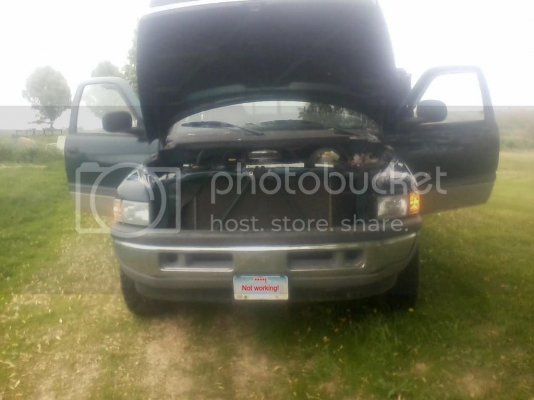

Festivities are over, so today I decided to tackle that combo switch and see if I could find the reason why my low-beams don't work when the wheel is in the (personally preferred) down position.
First, the replacement part...
Local O'Reilly's BWD part. Yes, "Made in China" but it seems damn near impossible to find replacement parts that are "Made in USA" these days.
Steering wheel cover removed...

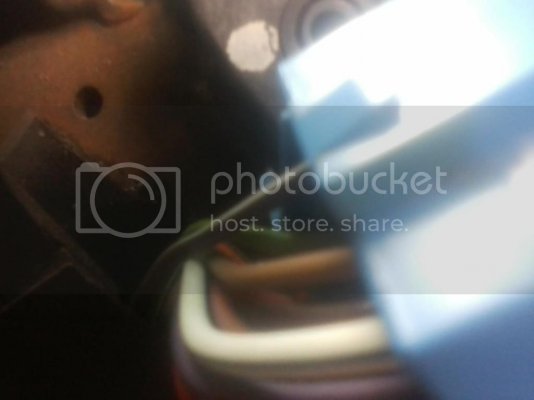

And now, armed with my new "weird screw type" driver set, I was able to remove those godforsaken tamper-proof torx screws.
After removing said screws and popping off the rear connector cover, I am greeted with a sight that I have all but expected to see ...
That would be a purple with white stripe wire popped loose from the connector. This wire is *drum roll* the hot feed to my low beams.
Just loose and dangling and totally NOT supplying juice to the low-beams...

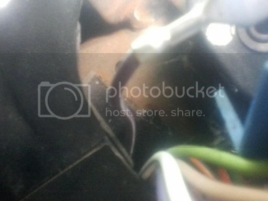

There's a tamper-proof torx screw that holds the connector into the switch. It was a bit tricky to remove but after fiddling around, I got it out and with a bit of flat-head persuation, popped the connector from the switch. I then pressed the loose the wire back into the connector until I heard the ever-satisfying "click" of a strong connection. I'm thinking "HOLY ****, are my worries over?!"

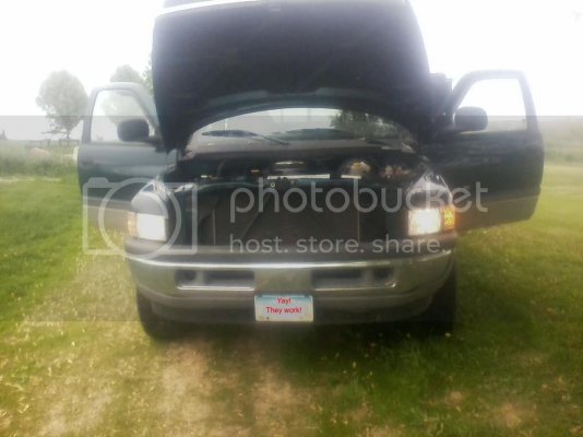

I install the new switch, re-connect the battery and...
NOOOOO, the low-beams still aren't working! I'm thinking "****, there must be another issue in the circuit." I head back over to the cab and notice this...
The damned wire popped back out from the connector (note the di-electric grease)! WTF? I'm guessing the "male" connector shoved the "female" connector away when I pressed the switch into the connector. I declare "Sorry guys, but this is one marriage that BOTH of you WILL say 'I do'" and shove the wire back into the connector. I turn the low-beams back on, walk back out front, and...
HOOWOO, the low-beams are working! With the steering wheel lowered! Finally, after years of messing with this super-annoying problem, it is resolved!
At least for now. I'm still a bit worried that the wire popped back out of the connector so easily, though it did press back in quite firm the second time. I fear that this isn't the last that I've seen of this problem but for now, it's fixed!
