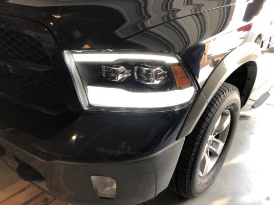

Good news everyone. I finished my Alpharex Pro Series G2 Install.
My 2013 1500 Outdoorsman came with the quad lights. They were way too dim compared to the LEDs in our BMW X3. So, they had to go. I ordered the lights from Alpharex and they came in 3 days. I replaced the 4 halogen bulbs with Alikee H7 LED units (Link below). After installing them I got low beam and parking light errors. Using AlphaOBD, I was able to remove the low beam errors but the parking light fix proved more elusive. I contacted Alpharex through the Book of Face about the problem. They sent me 2 resistor packs at no cost. This fixed the parking light error. Overall I am very happy with my choice.
The day after install we drove from Bakersfield to Salt Lake City and back over 4 days all to spend 3 hours with a family friend for her 91st B-Day. A lot of night driving was involved and the Alpharex plus LEDs worked beautifully. My wife digs the sequential turn signals.

Where did you install the resistors? I had the same issue and contacted Alpharex. They said they are sending me some resistors to fix the issue.

Hi!
As I recall, I unpluged the turn signals and put the resistor in line between the light housing and the truck's cable. I them tucked the resistor away in a place where it would not touch any plastic as it does get very warm.
I hope this helps. Craig.

I have this issue right now they sent me the resistors but forgot to send the t-taps so does anyone know what gauge wire they are so I can get the right t-tap

Same issue... They sent out resistors for me as well but I don't know if its worth the hassle of potentially voiding my trucks warranty as you would be splicing into the OEM wiring harness?

FYI I spiced and soldered then tucked resistor inside the head lights where they should have been for parking light circuit. Just used a multi meter to find wire.

I know with my 2016 1500, the G2s would give a turn signal error without a resistor (and despite any settings in AlphaOBD) due to the switchback function of the turn signal. I was only seeing the error on left turns; VERY occasionally the right turn would send the error as well. Either way, the signal actually WORKED- but it still sent an error that triggered the "ding" and message on the EVIC.
