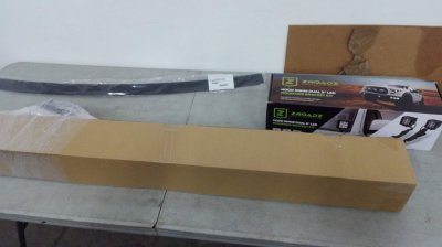

The kit was packaged well and shipped well. Brackets were well made save a few issues.

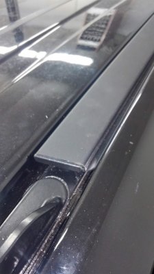

The rain gutters trim cut (step 13 in their instructions) ends abruptly. It just says to tape and cut the trim to allow room for the bracket. This can be easily cleaned up by removing the cosmetic front trim clip from the deposed area of trim, cut the finish end off at an inch long and use some butyl (or anything else) to secure it into the remaining gutter trim. This would mean the gutter trim cut in step 13 wound need to be cut at the correct angle which is very easy to mark. This leaves a much cleaner finish then cut straight aluminum.

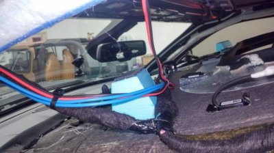

Due to the way we were running the switches I ran my own harness into the upper center console/switch panel and then down to the driver’s foot well. This would be easier for the wiring tech to finish the install without being limited on the relay location and supplied harness lengths for kit (Z390020S-A).
But I feel the cutting and butt connecting of the light bar harness (step 21 – 26) should be rethought. Instead of bringing the weatherproof connector inside the vehicle and under the headliner, running It cleanly outside was easier and more thought out for a few reasons. If there is a theft or damage and a light bar replacement is required, then the headliner doesn’t need to be dropped again. This is also cleanly done with longer 10-32 stainless allen bolts, a few “mounting cable ties” and extra 10-32 Stainless retaining nuts as I pictured. Just two more small hole drilled in the cooling fins for two retaining zip ties means no modification needs to be made to the LED harness. Since the kit comes with an unused pigtail for the other side of the LED harness, there is less work and difficulty to run wires inside. Butt connecting and heat shrink is still required with this, but no sheath trimming or extra cutting now or later if the need to replace the bar is required.

While installing the roof LED kit I ran a custom harness from our switch panel location down to the driver’s foot well with matching red, black and blue wires for the harness (Z3900020S-A). This way the headliner/interior would not need to be disassembled more than needed.

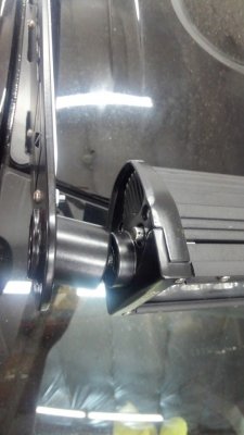

I put the bolts holding the LED lights to the brackets on threads up to keep the look sleek and clean. This way also leaves as much clearance as possible between the bolt and the exterior surface of the vehicle.
Anyone with a modicum of experience could install these - I do feel that the installation of the bolts being threads up should be noted in the instructions.

It took about six and a half hours to run the wires to a switch box I put in the place that holds the sunglasses. I would assume about half of this time was spent because of the switch. No matter how you install it - clean or dirty - there will be some significant time spent running the wires. I am running them so it looks OEM plus.
