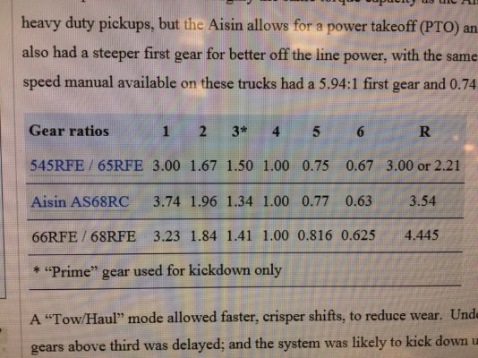

What are your rpm's with the 5.13's? I'm running 37's on a 2016 as well, and I can't seem to find reliable info on rpm's, even with calcs. Everything seem to conflict.
http://www.csgnetwork.com/multirpmcalc.html
Have you tried this one. Seems to be very accurate. Use the very bottom calculator....
Input ring gear ratio
Tire hight
MPH
Final trans drive ratio
The picture shows final drive ratios.

Thanks for the link
The Calculator you linked definitely is a good one. The one I linked and the one you linked come up with identical numbers, I checked.
If you’re looking for more complex calculator that includes under drives and transfer cases than yours is the one to use.
If you’re just looking for simple one for a 4 x 4 or 2 x 4 truck to find RPMs with a given speed the one i linked is simpler.
JMO

The math is technically the same but I linked to a page that will auto populate transmission ratios and give you comparative tables for multiple final drive ratios in every gear for user specified speeds.
