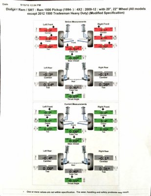

Here's a pic of my alignment after my drop, I kept front shocks stock and rear SP shocks with no adjustable bars. The guy said he got everything as close as he could and was within specs.

You can get away with running with just the BellTech stuff. Most alignment shops can get you "within spec" except for the caster adjustment. The Thrust angle is "within spec" but really should be zero to prevent crabbing as you go down the road. The only way to get the Thrust angle zeroed out is with a adjustable track bar. You really don't NEED the adjustable upper and lower control arms.

This is a good explanation for the most part.
YES, the bracket is of the utmost importance when lowering the rear of our trucks to get the rear NEARLY centered side to side.
I say nearly because if you look at the alignment specs that have been posted on the forums you will see that the Thrust angle is usually about .11* and not 0*. Granted that is within spec, the truck will appear to crab (track odd) from the rear. It's probably slight enough that most will not realize it. You can read more about thrust angle HERE That's why I recommend the adjustable pan hard (track) bar.
As far as buying the upper and lower adjustable bars, pass on them unless you're going to autocross or something similar.

Without the adjustable Spohn bar your rear differential will sit slightly more to the right. Don't count on your bed being perfectly centered either. When I installed the Spohn pan hard bar I measured wheel to frame rail to get the rear end close, then let the alignment text set the thrust angle to zero. When I first installed the BellTech kit I purchased a lifetime alignment package for $149, that way I can go back and get it checked when ever I want.
