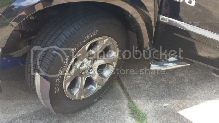

I taped using duct tape (that stuff will stick to just about anything) I taped sheets of construction paper to the tread of my existing tires. Had I had a desire to increase my tire radius I would have used shims/blocks to build it up but I like my 33's so I taped it directly to the tread and allowed the paper to project. I then proceeded to incrementally turn my steering and check clearances. I did this with various paper projections to simulate the wider stance and potential wheel rub. Next I repeated the same series of exercises with my floor jack positioned under the front of my truck lifting it slightly to simulate a minimal front 1.5" level kit and then a 2.5". Had I wanted to explore a lift I would have needed to bust out my jack stands.
As I said I know this is a crude example and its not a extremely accurate representation of what a final installed set of components will yield but I have alot more faith in it than the guy pulling information from the seat of his pants and wanting to sell me a 6" lift kit + lvl just to fit a new set of 20x9 0 offset wheel with a set of 275/60R20's on them I laughed at that one...

Me setting up my construction paper. An extra set of hands would have been helpful I used a straightedge to set my construction paper. This one is set 1.75inches proud of the existing stock 275/60 tires.
[/URL][/IMG]
Simulated unlifted stock with turned wheel at tightest position having a 1.75in wider stance (there is about a half inch of clearance behind/between my fender flare and the const papers leading edge)

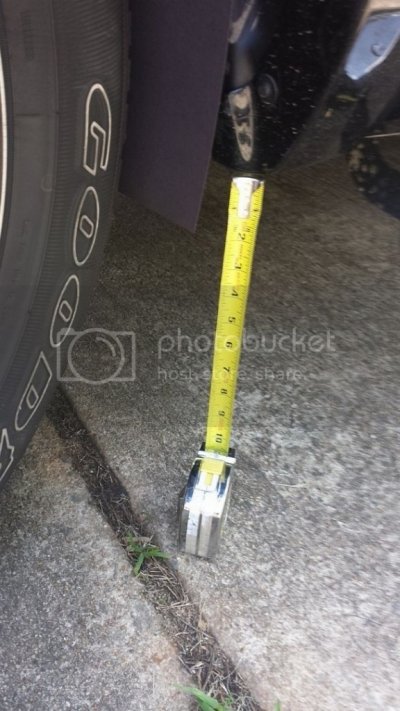

Established stock height without any lift at front of truck. Tape reads exposed 10.5inches outside housing.

Lifted the front of the truck up 1.5inches, the tape reads 12inches (sorry for quality of pic) This opened up the clearance between tire and fender to about 1" clear. The extra clearance is due to extended shock/spring which I suspect is not a true representation of what a lvl kit would due given it would not be taking the weight off the spring/shock but rather extending its length. I'm not sure just how much the delta is between the two.
[/URL][/IMG]
And one more this lifted the front of the truck up 2.5inches, tape reads 13 inches. The clearance stayed about the same 1in between paper and fender flare trim despite the angle of the photos appearance.

So in looking at my truck I have alot of clearance at the top of the wheelwell vs the front and rear even when considering bottomed out suspension conditions. So I checked realtive to my worse case postion for clearance which for the particular tire and setup I was looking at was on the outside face of the wheel at the rear of the front tire where my fender flares are closest. My inner wheel face and tire was minimal if any change depending on which setup I looked at so I wasn't overly concerned about my suspension clearance even in a compressed and/or turned axle state. So I proceeded with the crude test as the subject implies...
