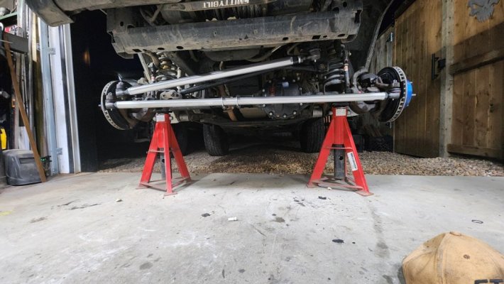

Started driving like **** when it left the exhaust shop? Did you figure out what was wrong?
Yes…definitely want the track bar and drag link parallel. Sometimes its tricky to “see” it because the track bars typically have bends in them. But yea, the straight lines between the two bolts should be parallel (which you obviously know haaaa). Did the lift kit on it have a drop pitman arm but no lowered track bar frame mount?
I know the exhaust shop story made me chuckle. Apparently they installed the teraflex tie rod/ drag link kit. There was so much not right I haven’t really got into the meat of it yet. The new steering box came with a loose bolt holding the pitman arm on so there’s that……. LOL

No brackets until I got it. View attachment 537685
Haaaaaa. Keep up the good work bro! Fixin others f ups is probly not your most favorite thing to do…but you should at least feel accomplished!
