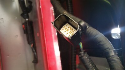

Here are the pics of the extension and the colors of the wires that are in it. I will post more pics after I redo it.
Don't forget to measure jeepguy1980's harness.

I depinned these wires and then put the harness back onto the truck to make sure the tailgate lock still worked... it did.

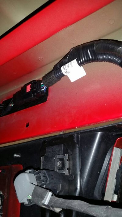

R.L.K the Orange dark blue wire was left hanging in the foot well the purple was plugged into its place already. I have checked all the wiring from camera forward to see if any bent pins. There is no sign of damage. I have tried to butt connect the Orange and purple but plan on taking it apart this weekend and solder them together. All pins at radio are on correct spot. The only connection I haven't checked is at the power distribution. The truck is an slt with locking tailgate.
The above photo is the connector the dealer assembled @ the end of the body harness that came through the engine firewall , this connector is plugged into your radio harnes the radio harness only contains three wires ( and is assembled from the factory ) , see below for its photo , the dealer could've easily miswired at the end of the Long body harness , some guys here have done this already . Make double sure the above photo of my connector looks exactly like yours ( use the top of the connector / the lock as a reference ) if miswired here it could be a simple fix of moving wires where they are supposed to be and instant camera OR they could have damaged your radio and or camera .
Please post photos of the above connector and the BACKSIDE of you C1 Radio connector and the tailgate end of the long body harness connector .
Below is my tailgate end of the long body harness for reference.
Another photo of the radio harness connected to the body harness
