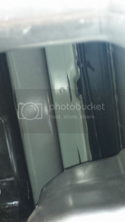

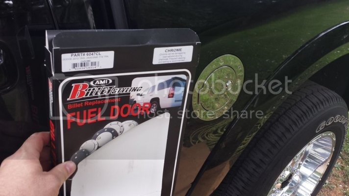

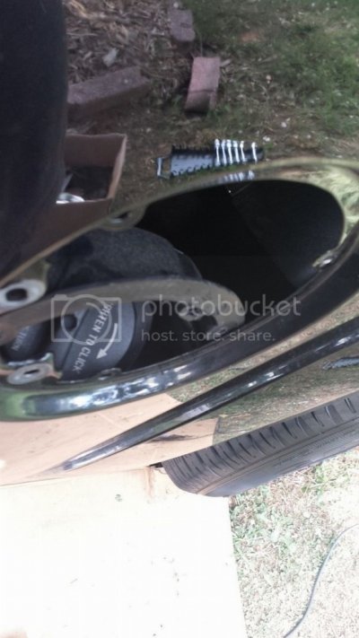

Managed to install my fuel door today, wow what a scorcher it was outside. I went with AMI's locking billet fuel door, part number 6047CL. I did run into one small snafu during the install that the instructions neglected to factor in, perhaps this is just because of model changes or something but mine had some rubber bumpers that obstructed the door install. Ultimately I yanked them out, simple enough but the plastic shroud housing them was still in the way so I took my handy dremel and cutoff wheel to it.

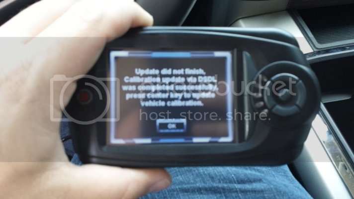

New Diablo Sport PCM and 93 tune via Trinity went in this weekend. Wow what a difference that made. I plan on taking it a step further in the near future - turning off MDS getting a custom tune etc but I ran out of time and wanted to keep it simple at first to see a baseline improvement so to speak.

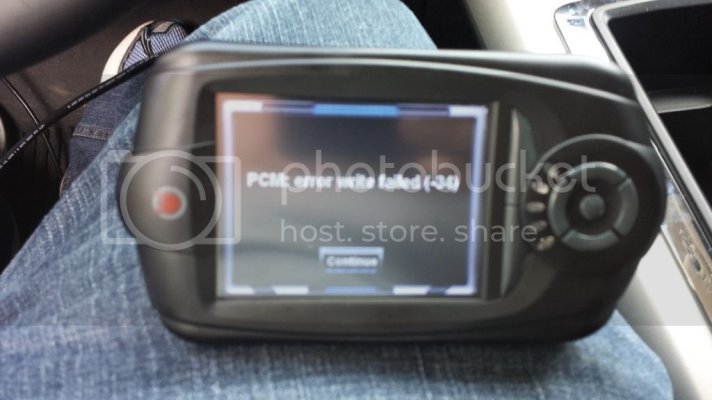

Ohh and for any others doing this same gig, even after I updated Trinities revision to include my newer vehicle it also required it run a calibration to be able to work on the new model which are obviously not in the instructions but I just followed the onscreen prompts. Unfortunately it had errors writing to the PCM and I was like oh crap / great my luck... and there closed for support. I simply tried again sorta like the mindset of rebooting a PC to see if it fixes the problem and Viola it took on the second attempt.
As far as the performance increase, its definitely there even makes the rear end squat when i stomp it whereas before it didn't. That occurs from standstill or at speed. I was however disappointed that I still cant light up the tires even with traction control off.

Here's some pics of those errors I got (sorry about the blurry photos)

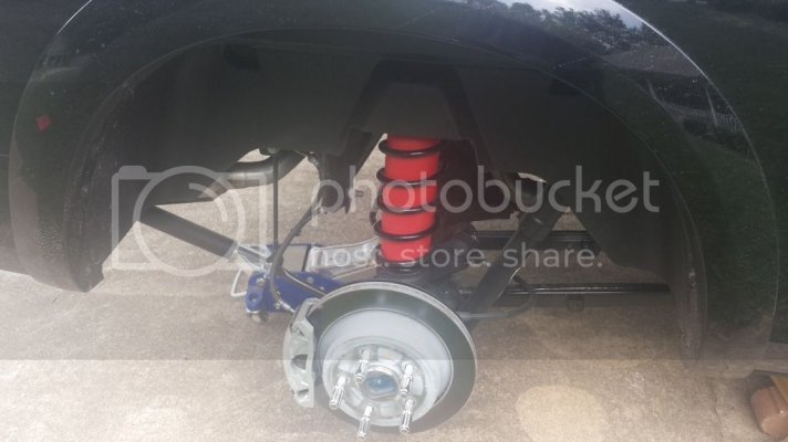

Installed the AIRLIFT 1000 to my ride this weekend. Everything was fairly straight forward but man where those air barb connections a real pain, boiling water helped but still tough... I opted to go manual instead of wireless to save the money given in the grand scheme of things I don't tow/haul frequently and could not justify the whole built in compressor setup. I ended up mounting the valve next to my gas cap so that when I fill up I can be reminded to periodically check my pressure and its a nice concealed protected location to boot. Below are several photos of my install mostly showing the path I choose for the routing of the airlines.
P.S. I only had about 1 foot spare of hose left, if I had opted to take it in the cab or much father elsewhere I would have been in trouble.
The before:
Bags in place, they even look sexy deflated lol:

Passenger side above shock:

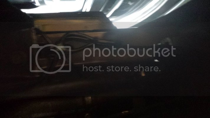

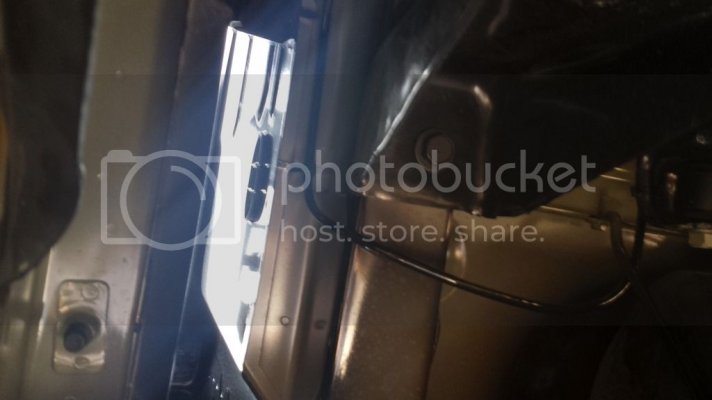

Crossing the bed above exhaust was easily over the recommended 8" separation to keep from melting the line, I'd say it was about 15" but I also have a modified exhaust at this location too.

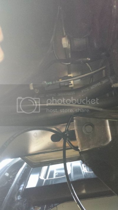

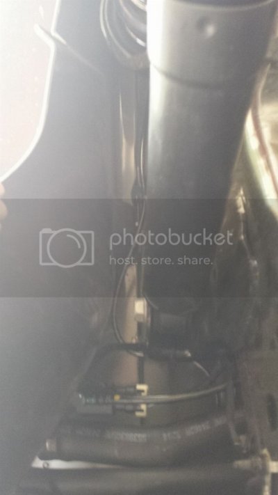

I continued it with removing one plastic shroud push on bolt and replaced it with a ziptie out in the middle and continued it over the fuel tank coming out the other side near the bed bracket with two holes perfect for another ziptie and that's about where I left enough slack for my "T" connection and terminated this end:

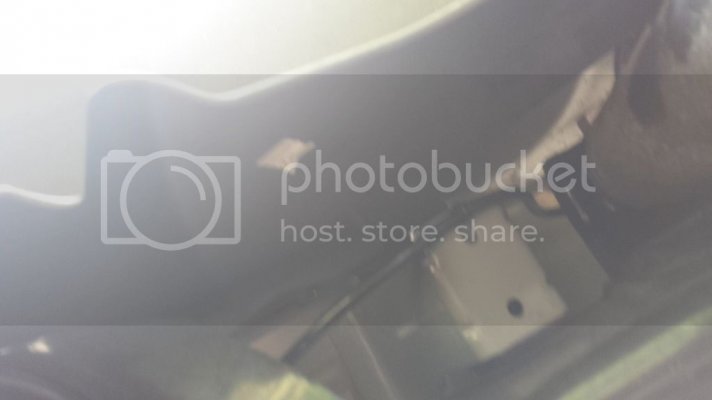

Onto the otherside, its a really a fairly short run to the same point, ziptie off at the shock head and ran over my fuel lines:

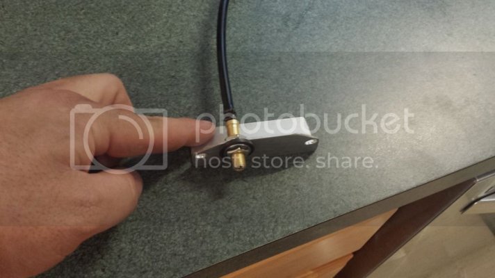

Next up I made a little bracket out of light aluminum angle I had on hand. I figured the angle would help with stiffness for pushing and pulling on/off the air valve and it seem to fit the bill otherwise. I opted to utilize the same two threaded bolts inside the hinge area from my aftermarket fuel door install. Oh and yea I precut my hose and madeup the connection to the air inlet and the plastic T in my Kitchen, so much easier...

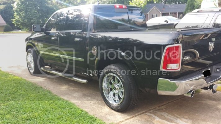

Man your wheel fitment on this truck looks awesome! I just stare and the head on picture and drool.

Looks awesome! Planning on those same wheels for my 2015 Laramie so your pictures helped a lot. Also doing a few other things you have now that I see pictures! Thanks
