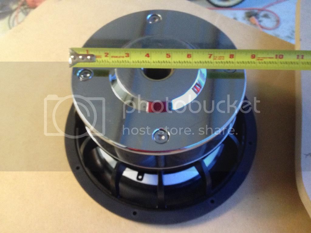

the beauty in question...
just about 7" deep
The issue comes in the width of the magnet... ~8.5"
