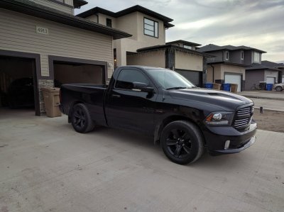

I did the Belltech rear 4" drop kit (coils, bump stops, track bar relocate, street shocks) added Airlift bags and Ground Force front 4x4 springs to my 2016 with absolutely no regrets.
The front springs have since settled another 3/8".

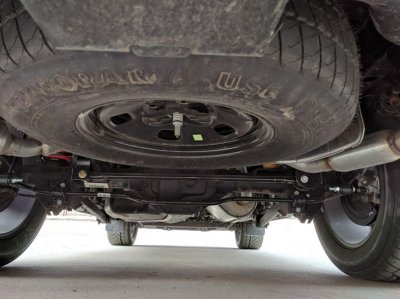

Mine truck also did not have factory air suspension. The Airlift kit is not required when lowered. I added it as i sometimes add weight in the bed and don't want additional sag. I also played with the PSI in the bags to get the ride / height i want in the rear. The photo i posted above is immediately after install w/ no air in the bags.

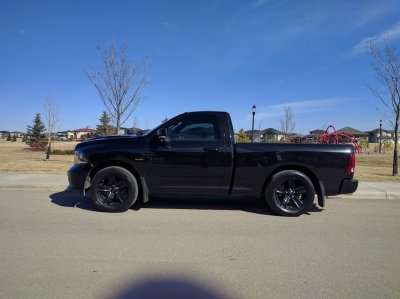

I did the front springs and belltech rear, I got just shy of 1" of drop on the front which is bs since I paid an arm and a leg for two coil springs.... Ride quality is fantastic though.
