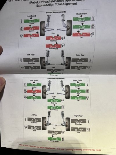

IMG_3460.jpegthese are my setting after getting An alignment at just tires. The right side wore pretty bad in the outside edge. It’s still wearing pretty bad after only a couple hundred miles. Any ideas? Suspension related? 2019 ram 1500 with rough country 6 inch lift.

You didn't say if its front or rear but looking at your toe, I'm going to guess your right rear. Idk that .35 is a LOT but from what I've seen its more than you would want.
If you're asking about the front then idk why.

You have no camber. The front tires are standing straight up instear of leaning out some at the bottom. The right tire will wear more on the outside, and the outside left will wear on the outside also.
Also, is your truck pulling to the right? There is way too much caster on the left front.
The way the camber is, your tires will roll over on the outside edges when turning and wear the outside out.
Your total toe at .09 is within acceptable range.

it’s the right front that’s wearing bad and yes it pulls to the right. What kind of numbers should I be at to help with this problem?

The only thing they changed on your truck was the toe. The different camber reading on the left is probably just settling of the truck on the lift after toe adjustment and jostling around.
Take some of the left caster out of it. Changing the caster will move the camber on these, so take it back where you had it done and have them redo it, then drive it. If not right, go back until it is, or have them refund and go somewhere else.

Looks like a "toe and go"- they set the toe and sent you out the door. Camber/caster is adjustable on our trucks and it's an easy adjustment compared to some other vehicles. There's nothing you can do on the rear without adding alignment spacers and those are an expensive job. If it's a random tire place, you might want to look elsewhere for an alignment. Ask around at 4wd or performance shops who they use. I was an alignment tech at Firestone and Sears Auto many years ago. Some guys I worked with spent more time racking vehicles than setting the alignment properly.

Your front toe was messed up initially, fixed after, but they didn't address the little less caster in the passenger front, so the vehicle will tend to drift towards the side with less caster. in your case there should be some drift towards thge passenger side. Most road crowns will lean right so lots of shops will set the caster a little lower on the driver side to compensate. in your case that's backwards. Asides from that you have something interesting going on in the back with your toe in the rear passenger compared to the driver side and the trust angle. Have you adjusted your rear control arms or your kit uses brackets to correct for height ?
