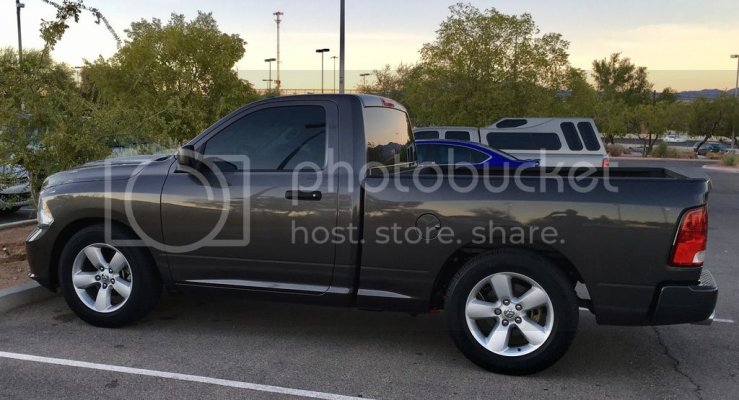

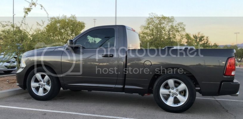

I remember very clearly that my rear bump stops were as close as yours and I even posted that here somewhere (I looked for a picture, but can't find one). I thought it was so close that it was probably going to ride on the bump stops most of the time... So I cut about an inch off of it.
Was your spare back in when you took the pictures? If not that could be part of the reason why yours sits a little higher than AK47s...
No, now that I don't commute anymore, spare is staying off, good point

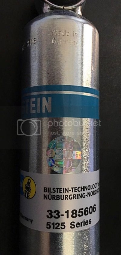

ok got my new rear shocks on order, went with bilstein B8 33-185606 with 255/70 digressive valving, my eye-to-eye ride height measurement is 19"+/-, shocks compressed height is 14.1", extended 22.5" and some airlift helper bags!

I guess when it comes to figuring out the right length for a shock, you need to fall within the window of fully extended and fully compressed when going through a normal range for the suspension cycling. Correct?
How much are those rear shocks? I did not see a price anywhere (guess you have to go to a dealer site?). Let me know how your experience with them goes. I am not super savvy on shocks and what makes one better than another. I just know that everyone says the QA1's are the best (or one of the best) for these trucks when lowered. I suppose there could be other shocks out there equally as good, we just do not know about them in our particular application.
your diagram is right on man. I just called Bilstein and told them what I had and the turns out the shock they recommended was the one I picked out. Just needed to confirm it would be a solid choice.
hey, someone has to try something different to get some comparative data, lol, they may end up being $hit!
I chose the B8 5125 series because they are made for lowered vehicles and have the digressive valving I was looking for, also I've read alot of autocrossers use digressive valving, but of course I want first hand experience on that as well and I have none thus far.

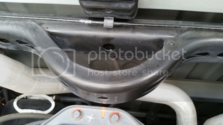

can someone tell me what this is for or its purpose?
DavidRam
Feb 19, 2014
9,094
3,921
SoCal - Redondo Beach
2012 RCSB
That is for a 5th wheel hitch. I cut mine off because it would have hit my Mag Hi-tec diff cover... Make sure you aren't getting to close to it, I can't remember if others had problems of it smacking there stock diff cover, I don't think it's an issue...
yeah, thats gotta go!:emotions122:

very cool thread, thanks a bunch. With 8000 trouble free miles I believe the setup has settled and I am super happy with the look. The back sits @ 34" and the front @ 33 1/2, my eyesight is horrible but when 20" away from the truck it almost looks like the truck is level. Happy motoring!
M
moregrip
Apr 19, 2015
614
222
thanks man, enjoying the build; always good to have a fun project to tinker with! Looks like mine sits about an inch taller all the way around:favorites13:

Uhhhhhh, these rear bilstein 5125's are damn awesome! Without a rear swaybar the rear of my truck is a totally new (read better) handling beast.
Really impressed and surprised.
Of note, my seat o'butt meter is telling me the rear sits higher now, will take measurements when I get home to confirm ....
Wow, what a difference!
Funny that my stock rear shocks are Tokico and my stock front shocks are Hitachi......
