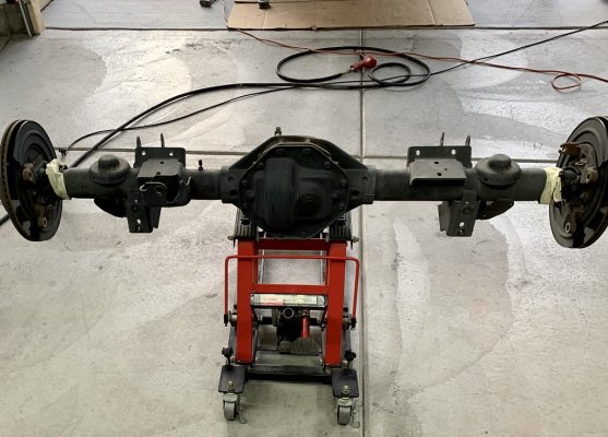

If you're installing rear relocation brackets ,allow yourself lots of time,they are a bit of a pain to install,lol
I'm hoping a day and a half will be enough for the rear relocation brackets? Using a plasma.
It's almost easier to do them if you drop the housing out from under the truck,you can do them on a lift,but it's not as easy.

stock brackets cut off; what did you use to drill the holes? Right Angle drill?
