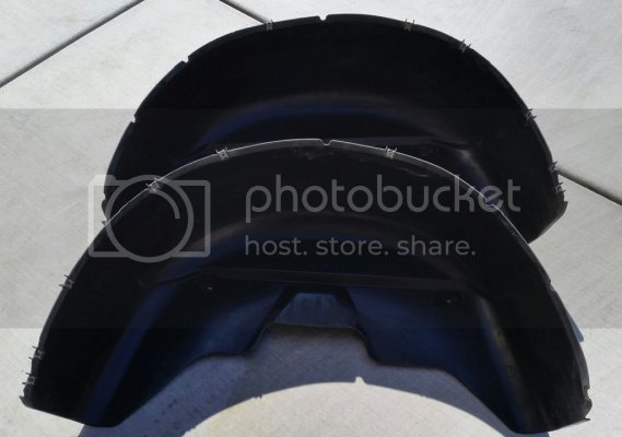

got some prep work completed today:
rear liners removed and now I think I'm going to leave them off......I like being able to see all the suspension and stuff:

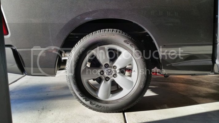

measurements taken from the ground, center wheel, to the fender lip, lowest point in the opening
LF 36 1/4
RF 36 3/4
LR 39
RR 39 1/2
so the right side definitely sits higher than the left
about 1/2" in the front
about 1/2" in the rear

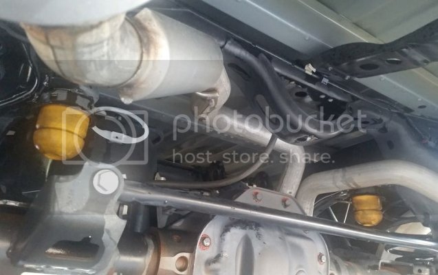

ok ran out of daylight but here are some of the additional measurements I took:
Distance between the "lowest bottom edge of the bumpstop cup/holder" to the "bumpstop pad" on the axle:
L 6 1/4"
R 6 1/2"
Additionally the free length of both Belltech rear coil springs are 16" and the coil diameter is 13.25mm. I will measure the stockers when I get them out tomorrow morning.
As she sits now, all bolts are loose, just need to drop the axle down and swap the rear coils out.

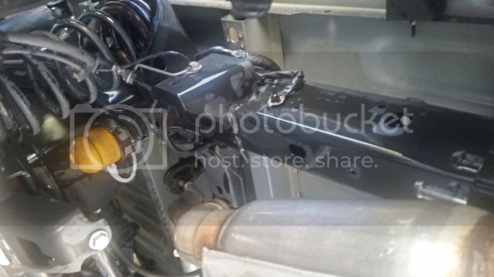

Little update, drop springs are in. At ride height the distance from lower bumpstop cup to bumpstop pad is: L 3", R 3 1/8".
Of note stock coil spring free length is 18" and is progressive in two ways. First part of the spring is 13.5mm and wound tight (lower spring rate), second part is 15.5mm and wound more openly (higher spring rate).
Rear end shifted about 1/2" to the passenger side. Pinion angle is visibly different, haven't measured yet........lunch break.

Ok so the rear is done for now but I will have to make some adjustments because the axle is sitting about 1/4" to far back in the wheel well.....which sucks because I had all my measurements within 1/32" of each other side-to-side and front-to-back.....but hey she's well on her way!

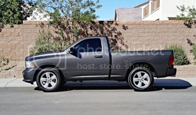

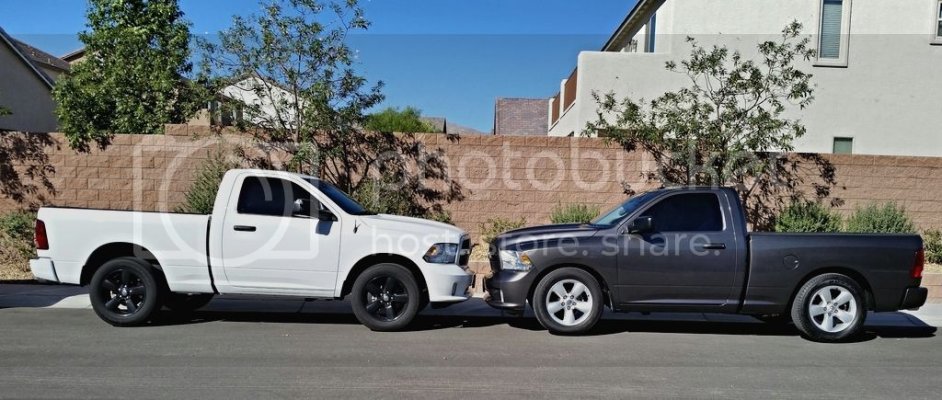

before pics for perspective:
Ak47bravo
Jun 15, 2014
320
64
Houston
Nice! Looks awesome!!! Curious to get your feedback on the ride quality/performance.
