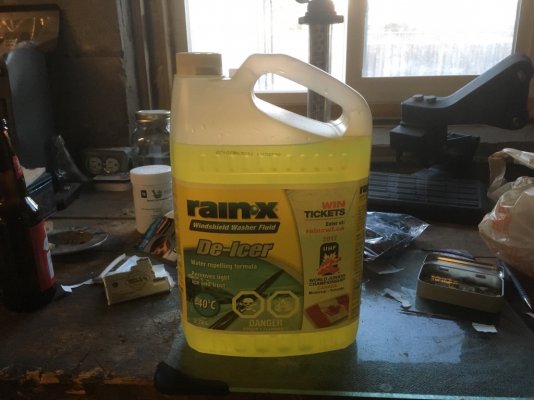

I just bought a case of Rain X on sale. I used it for 2 years in my 2015 without issue. Mine is like a green colour, not sure of the difference. I says de-icer as well on the case

I've had only minor issues with sensor with the yellow deicer rainx, Mostly when in sub -25C. It goes away.
Also order replacement sensor from rock auto for 2 dollars. Will be soldering in a resistor when it warms up and i do some bench tests. same sensor in dodge journeys.
I've used rainx on every vehicle since 2001. no way i'm going back to that blue ****.
