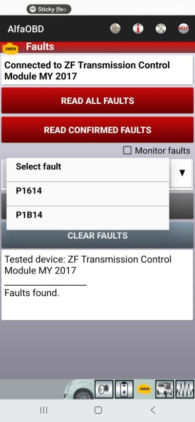

Well, hopefully I didn't really mess this up, I doubt it with only 100 miles and a quart low. But just left work, and the light popped on again. I had my OBD2 with me, so I read the codes, and it was throwing the p1614 and p1b14. I tried to clear them, and they immediately popped up without even starting the engine, just a cycle of the key. Did this a couple of times and came back. Had my jump box with me, so I threw it on and cleared them. They didn't appear to come back, so I may have a battery starting to go bad and be dealing with a bit of a voltage issue or a bad ground. See what happens when I leave work. Hadn't seen this message before the service, so I tend to believe it was caused by low fluid and will clear up, or I knocked a wire on the transmission, or a weak battery. And adding the transmission fluid didn't actually clear it up, but leaving it running while I was adding the fluid, and the battery getting more of a charge did for a short while.
A weak battery makes sense for the random check engine light with no code a few days ago. Also, not sure about Chyrlser, but Ford loves to hold on to codes until you get voltage stabilized above 14 volts and clear them, so maybe it's gone now for good. We will see if it's running fine with no symptoms, though, so not crazy concerned. Really just wish I hadn't let the teenager take it because god knows how many times it popped up on him, and he didn't say anything.
