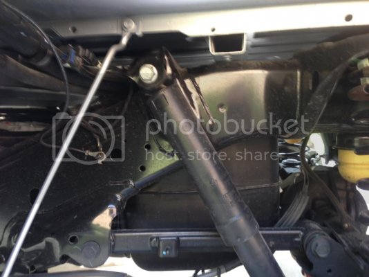

Here is the stock rear end with the fender liners removed.
I used a 13/16" crows foot on a 3/8' breaker bar for the nut side and a Craftsman 1/2" drive battery powered impact for the bolt side of the shock nut.

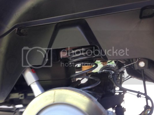

Here is the BellTech Street Performance rear shock mounted on the upper perch.

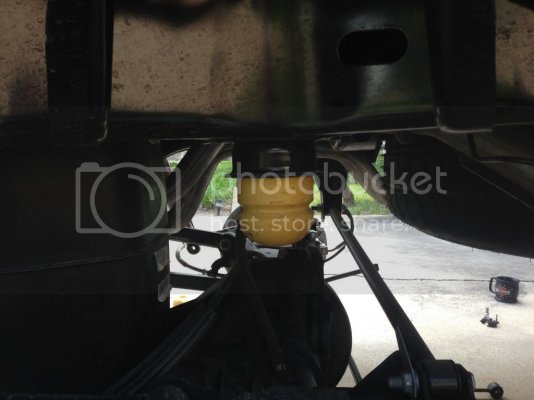

Here's a comparision of the rear bump stops.
Stock
BellTech
Spring comparison.

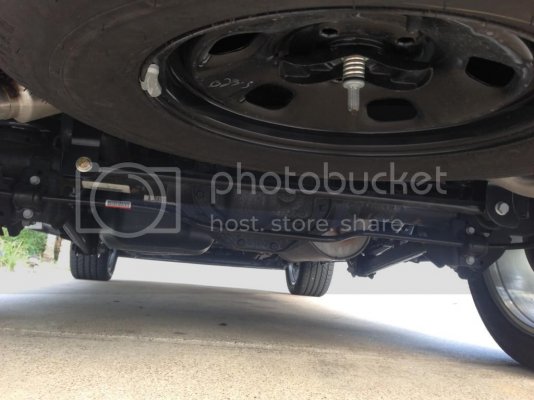

BellTech's PanHard Bar relocation bracket
Here is how the PanHard Bar sits with the truck back on the ground.
Rear suspension complete! You can see the sway bar end links BellTech provided in this shot.

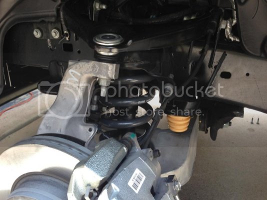

Stock front end.
Didn't really take a bunch of front suspension photos. Here's a shot of everything back together, along with the BellTech bump stop. You'll notice i reused the stock R/T front shocks. I did this because I really didn't like the bushing for the top shock mount on the BellTech shocks, and I had read a couple of threads where guys said the BellTech front shocks didn't ride that good. So, back in went the stock R/T shocks. Of course I tried to use the stock upper shock mounts on the BellTech shocks, but the stud wasn't long enough. This added to my install time as I tried several different combinations using the top shock mount bushings. In the end, I think I made the right choice.
When I took her for a spin today the ride felt better than stock. Turns are flat with very little body lean. Braking seems to have less nose dive. It got late on me, so tomorrow I'll get her aligned.
