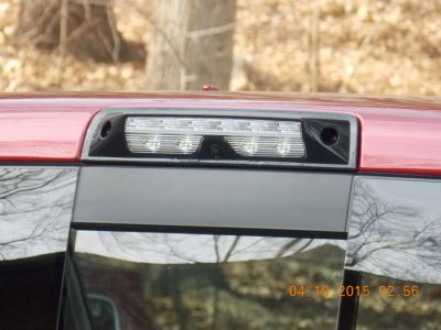

It happened on my truck at 4000 miles, dealer replaced the entire third brake light assembly no charge.
But back to the LED 3rd brakelight, there is in fact 2 led CHMSL assemblies available stock from the factory.
One looks very similar to the incandescent one while the other looks very different with a camera built into it. Both come on the trucks from the factory.
Ironicaly after the dealer replaced my incandescent one I replaced it with the LED one with the camera, mopar pa. rt number 68163937AF. I do not have the part number for the mopar one without the cam but I have seen them on 2014 and 2015 trucks on the lot, with mopar stamped in them.

Here is a pic of the mopar Led CHMSL Cam

FYI my truck is a tradesman, which I upgraded abit, but again the LED brakelight is OEM mopar and available from the factory though it is a rare option, only offered on the 3500 as a means of hooking up a gooseneck or fifth wheel hitch. It may be avail on the 2500 but im not sure. But it could be added to 1500, 2500 and 3500 especially with the 8.4 radios.
