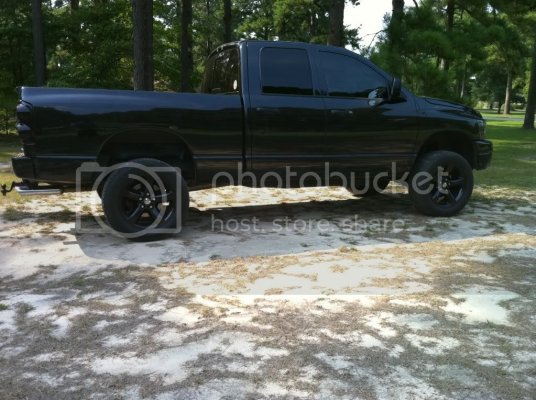

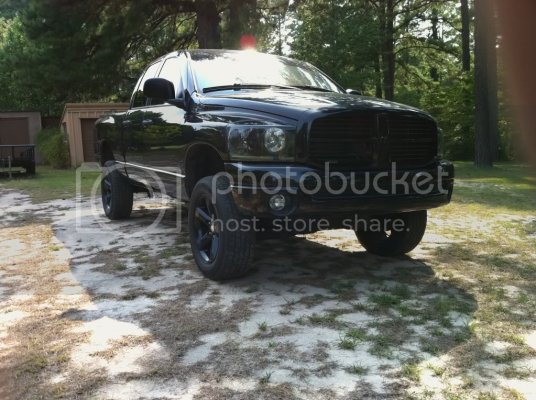

Okay well i finally finished the Zone 3in body lift on my 07 2wd...it helps quite a bit. Its a long process, quite a few steps and mine required some self fabbing and scavenging for bolts. It took around 15 hours both by myself and with buddies. I welded on the front brackets as well as the crush blocks. I skipped quite a few steps such as draining the radiator, parking brake relocation, etc. My brother also broke the ribbon in my clockspring, so i had to disconnect my horn and am waiting on one to come in

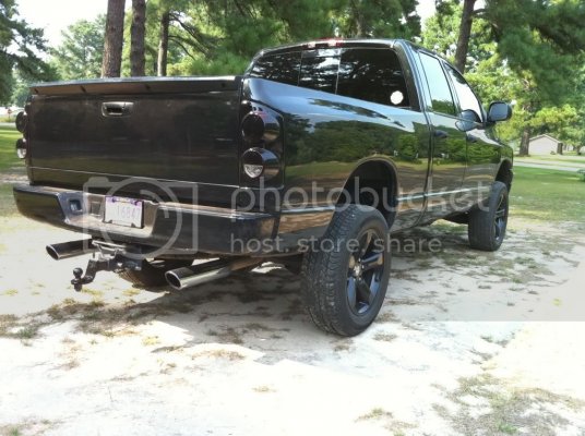

All in all im pleased. This is 5.5in on the front, 4.5 in the rear. Makes the 33s look small. I think it drives better than before, its weird but my UCA/Spring Bucket problem isnt as bad. I dunno.Gotta fix my exhaust now also
I dont know why this pic makes it look unlevel, but its more level now than its ever been. I dont have a pic with me in it, but the mirror is at the same level as my head and im 6ft tall

looks good Matt....makes me want to start in on mine for my 4x4. What are your future tire/wheel plans, if any???? What was the ultimate trick to get the steering spacer in??

Looks good man, level that thing out too while you're doing everything...

I think it is leveled.....Are you planning on getting rear liners to clean it up??

I undid the top of the boot around the intermediate shaft and sprayed PB, then awhile later I took a 2ft breaker bar, 1/2in extension and a socket that fit over the end of the shaft and gave it a good pound with a BFH. I hit it with a rubber mallet and a clawhammer and nothing, the BFH got it quick

Its completely level (front bumper is .25in lower) that pic makes it look like that for some reason
Yea im in the works buying a set from a guy but if it dont work out ill be rocking my homemade gap guard till i get outta school in Dec lol

My bad man. The pic does make it look really off.

Very nice Matt. Yeah, the exhaust needs to be pulled up now a little closer to the rear bumper and definitely some new tires are in order. Over all though the truck is looking sick man. I just don't know how putting the bl on would lessen the uca from hitting. Huh, hey that's another upgrade then.

Cowboy, me either on the UCA issue....maybe a weight deal? Putting a little less weight on the front would help...
And yea the 33s look tiny. I didn't think it would be this bad!
Y'all think I should dump the exhaust instead?

Dump it. I did with a cherry bomb extreme.
