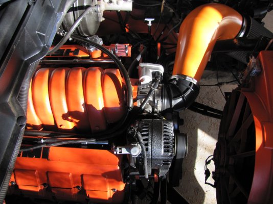

It is called a BFI ramhammer, and is what is pictured above. Only problem is that they are no longer made.
This design is as good as it gets. What happens is that as the air is going into your filter you are sucking in 6" of air. As that compresses to a smaller diameter, it will increase the velocity of the air and in turn make more power.
That is the main reason why our port design on our throttle bodies starts out bigger at the outside of the tb, and then closes up a little at the TB blade.

Matt, how bout making ur own variation in a different material, I would def buy one

Mybe go like 5 or 5 1/2? I remember these, Lance......had a great design, but my guess is couldnt keep up with demend

I dont know what happened to him personally, but he ended up taking alot of money from mutiple people and not delivering the intakes. It basically ruined his name and the company all together. JJ used to work with him, so I'm sure he knows much more about what happened than I do.
As for building these myself, I have not even looked into this. I would rather it be made of plastic than metal, but this might be something for me to take on in the future.
