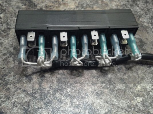

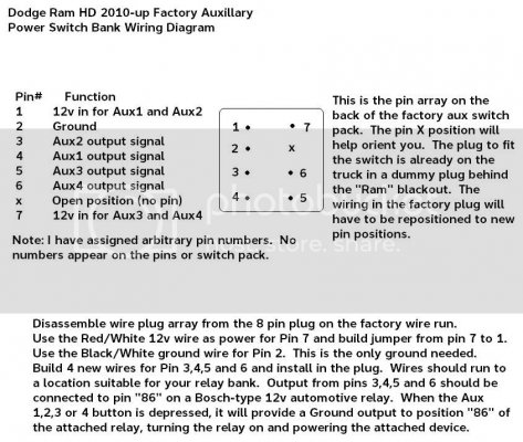

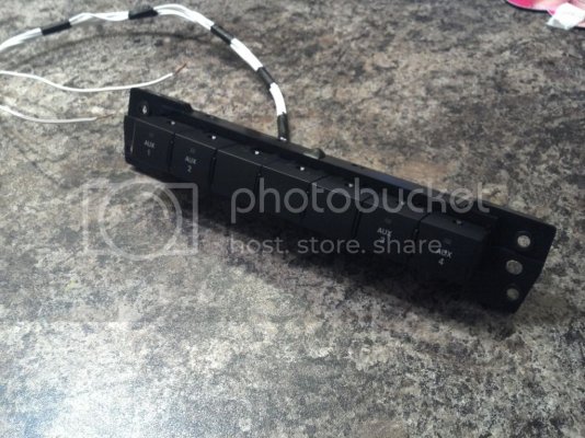

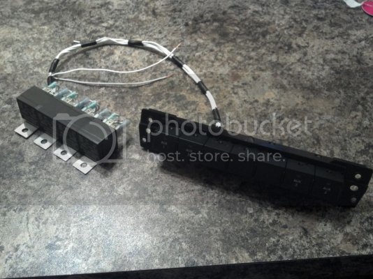

I got my switch plate in yesterday and made a simple relay pack for it that will mount behind the dash somewhere. I only wired up the coil side at this point so I will just have to wire up the contacts as needed later when I add accessories. Not in a huge rush to install it just yet since I have nothing to power with it, but I did test it with a 12V power supply and it works like it should. Two of the wires get wired to a switched 12V source and one to ground. Then one side the coil to 12V and the other side to each output from the switch. I wired it up so I just have a 12V wire to connect and a ground.

Mounts in place of the RAM logo on the center dash. Trucks with more options are all ready going to be using the space though for heated/cool seat switches.

No the center 3 buttons are just dummy plates and do not operate. Also, they do not light up like the factory buttons do, only the little square above the AUX lights up orange when the switch is on.
