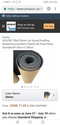

What does the CCF do in this equation?
Stops the door rattle, since door is all plastic. Wrote last response fast, so here's more detail. The trucks door skin is just plastic, with multiple plastic areas plastic welded in, so some are not completely solid, so creaks, rattles etc, especially around the door switch and pull handle. Any self stick closed cell foam helps reduce the sound and since it's thick, it puts some resistance on door panel so it doesn't make noise. For overall stopping rattles etc, it is best. The sound deadening I put on actual door of truck, 50mm should be fine, I did 80mm and is kind of heavy, but makes difference. Even with the subwoofers not in truck, the bass coming out of the doors sounds much better. The closed cell foam I used in past I bought from China, but I just ordered a piece from Amazon for under $12 from brand Xcel, is like a 4 foot by 4 foot piece, self stick, for finishing off the install. Once I get the soundqubed Amp Saturday will work on finishing it all off. This stuff is thinner than the last closed cell foam I used. I would prob look for thicker for at least front doors.

So, Closed cell foam's function is purely mechanical. It's a decoupler, it's only purpose is to keep one thing from touching another...hence the yoga pad lol. That is why people use ccf between their Butyl deadener and mlv. Think about it...CCF is impervious to water and air due to its closed cell nature, how will it absorb sound? It doesn't. Open cell foam would technically be better at "sound deadening" but no one uses it due to it absorbing water. Regarding ccf "deadening" or limiting resonances, there just isn't enough mass to block or tame anything meaningful. That's where butyl based tiles come in...and 80mm tiles will always be better than 50mm....that is what were are doing, we are adding mass to a panel to reduce resonances...nothing more. CCF has its place for sure. It's thickness has a direct correlation with what frequencies it will redirect. Some will use CCF pads right behind a speaker to redirect back waves...they are pretty thick pads. I remember a competitor wanting to redirect the back waves of his very large midbass and was having issues around 500hz...his ccf pad had to be atleast 4.5" thick to redirect 500hz frequencies. Use ccf as a decoupler, and maybe filling some gaps between two seperate spaces
autokraftgt
Mar 28, 2013
1,259
513
Hemi 6.1
For our back walls, floors, doors, firewalls, roofs, hoods etc...if you want to deaden rattles and buzzes, use the thickest butyl based tile you can. Also, 80mil products are not all the same. Remember, we are simply adding weight and I can confirm that a 80mil Stinger Roadkill deadener is about twice as heavy as Noicos 80mil deadener. I did a side by side and there is a reason Noico is priced the way it is...its way lighter stuff than your higher end deadening tiles.
If you want to take sound deadening to "sound proofing"...you must introduce MLV....however MLV is useless without a decoupler (CCF) So your layers go as followed. Deadening tiles, CCF, MLV. MLV will be the only thing that reduces road noises (higher frequencies) wind, rocks hitting wheel wells, wind noise coming into your rear air vents on back wall, tire howl etc...

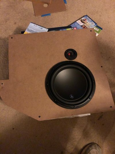

I know this is kind of an old thread, but do you still happen to have your templates? Wondering how you went about making them
Hey man, I think I may have a template in the wood bin but not sure...
I just used a large piece of cardboard and marked it and trimmed it until I had the shape close to what I wanted. Then traced it on to a piece of MDF and cut and sanded that until it was just right. Then used a router and a flush trim bit to make an exact match.

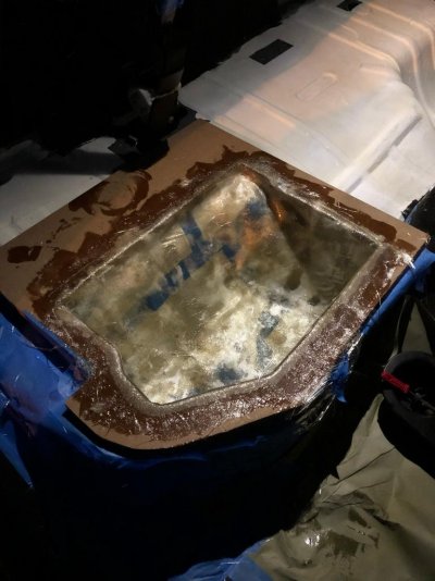

Nov 25, 2018
13
Arkansas
Just wanted to follow back up and let you know I ended up creating my own template and making a box myself! Thanks to this thread it wasn’t so bad. I definitely need to work on my fiberglass skills, but it sounds good and doesn’t leak! I did end up having to trim some of the MDS back by the seatbelt, but it fits pretty good174e3d2753e9397bfc30be0e8a049ba5.jpg
Power247
Power247
Jul 26, 2012
5,615
947
High Point, NC
6.4 HEMI
Looks like it came out good. Nice work!
