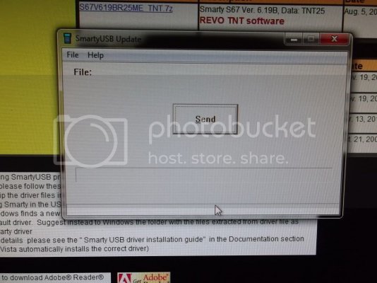

5. That will download, and ask you to save it. Save it to a folder you can find later on. Once saved...ckick on "RUN". A window should pop up with a BIG button that says "SEND"...go ahead and minumize that.

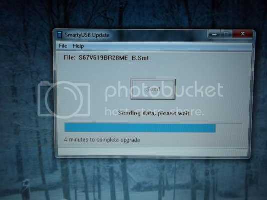

14. Step 5...the USB thingy you minumized...go ahead and bring that up. Plug your smarty into the USB port.
15. Click the "SEND" button...this will bring up your folders. Go and find your fancy folder. Once in your fancy folder... find that "software upgrade" that has a bunch of letters and numbers fallowed by ".smt"...click on that...then click open.
16. Once you click open...you will see in that window that its updating your smarty. Should take roughly 20-40 minutes to update. Once finshed it will say "complete"...unplug your smarty...plug it in your truck...and go blow your tranny up
