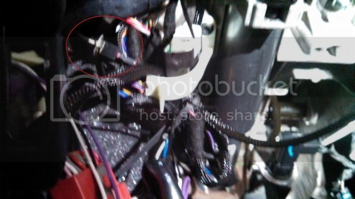

• Unplug the ignition plug and there is one on the THCHD3 T Harness that will go in its place. There is also a female receptacle on the harness that will receive the factory plug that you unplugged from the ignition.
Harness Ignition plug in place, factory ignition plug plugged into harness.

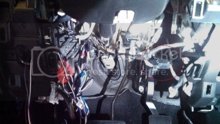

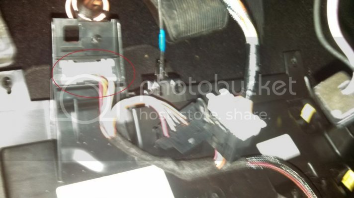

OBD Plug and Port
Removing the factory OBD from its location was a bit of a pain. There are two clips on the side of the plug that hold it in place. You have to squeeze these in and push it out through the back. It’s not overly complicated but it took a little time as I didn’t want to break anything.
Once that is out, there is an identical OBD on the harness. (There were two, a white and a black. My original was white so I went back with the white.)
The harness OBD snaps right in where the factory came out.
Then, just like the ignition there is a female receptacle that will receive the factory OBD and a slide clip that will lock it into place.
Notice the black plug in the circle on the left, that’s the other OBD that was not used. The plug on the right inside the circle is the factory OBD into the black female receptacle on the harness. And then out of the circle on the left is the harness OBD port where the factory one came out of.

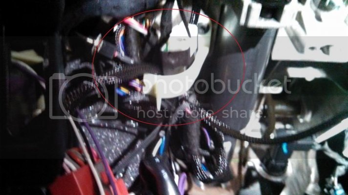

Clean up
• I found a clip that wasn’t be used by anything so I cable tied all the wires neatly and the pack fit right into this white clip.
