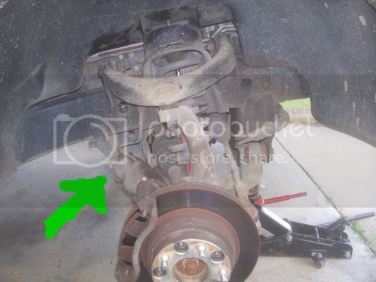

remove tire

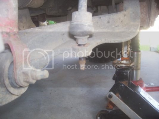

remove brake caliper and secure out of the way ( i set it on the lower a-arm)
disconnect the sway bar end link from lower a-arm

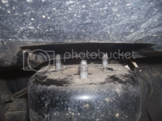

remove top 3 spring assembly stud nuts. (15mm)
disconnect the upper balljoint from spindle

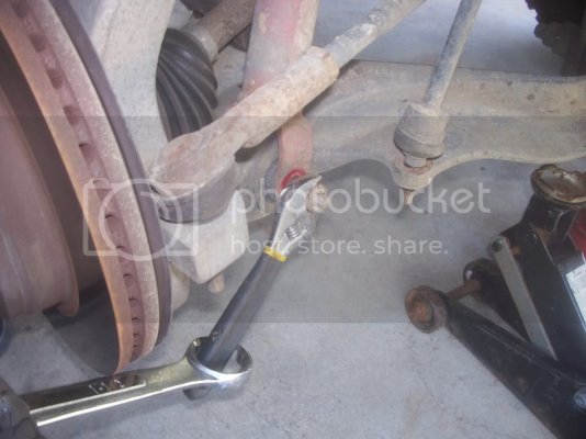

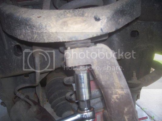

remove lower shock bolt ( i didnt have a wrench to fit so i used a cresent and a 1-1/2" wrench as a cheater bar. worked great. this thing is a booger!)

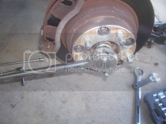

remove the hub retaining nut. ( if you dont the cv axles will pull apart inside of the boot and are a motherf*cker to get back together!!)
1-1/2" socket and ratchet works well theses arent super tight.

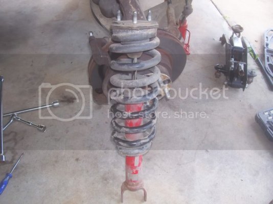

now you can pull the spindle out toward you giving you room to pull out the strut and shock assembly
at this point the actual work begins!

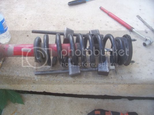

compress your spring AS MUCH AS POSSIBLE!!. i rented a strut spring compressor for $55 deposit at autozone. this is very fukken tough job without air tools.(which i didnt not have an air source!) make sure you tighten them evenly back and forth.
then you can just simply unbolt the top shock nut........ takes a 18mm.
but more than likely it will be corroded and its a locking nut to boot so.. ingenuity comes in handy here. there is a special tool for this but the 5/16" stud that you hold while removing the shock stud nut broke off both of mine so we- ( thankfully my father brought me his grinder and beer!! yay dad!)
grinded off the top shock bolts. THIS WAS MURDER!! we finally got them off.

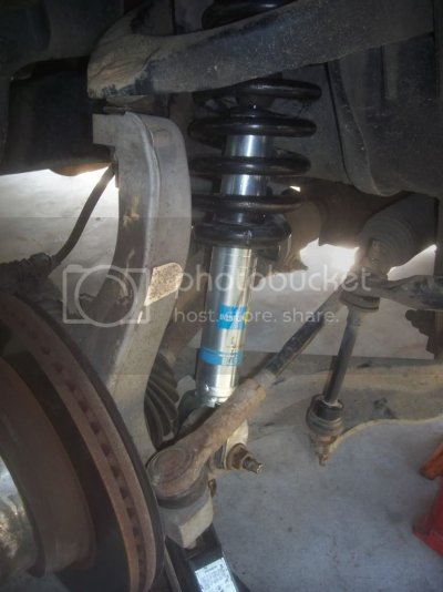

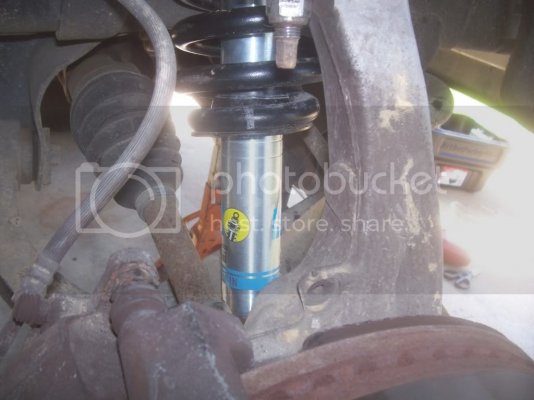

that spring perch then installs on the 5100's, replace spring, and oem spring cap with the 3 bolts. then use a 18mm wrench and T-40 socket and tighten the top spring nut to 35 ft/lbs
now your ready to reinstall...
installation is reverse of removal .
** tighten the lower shock nut with the weight of the vehicle on it!

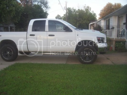

now that you are completly worn out and sore and cant hardly walk its time to take an after pic of your new leveled truck!
didnt take a before pic :slap: but i gained right at 2+ inches in the front. my truck was raked very bad before
