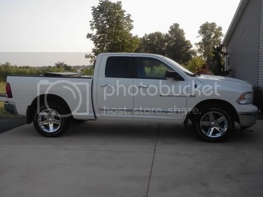

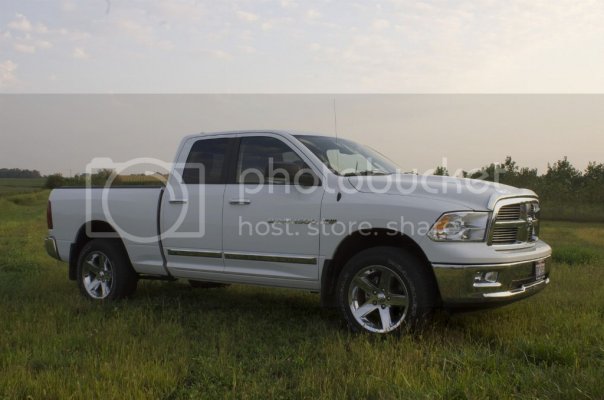

Pics tomorrow. I'm tired now. Also need to adjust my lights down. Didn't even think of this till I was headed home.
Sorry 7 small cars I passed on the way home.

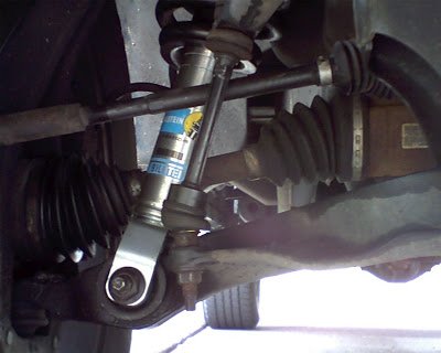

I noticed the angle of my ''cv '' joints after I did mine. I also adjusted my lights.Didn't take much.

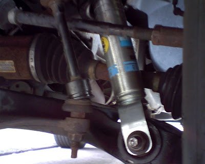

Where's the meat an potatoes? ya know , these kinda pix.
lol.

Old pix too! lol. The rubber grommet has long been fixed. lol.
