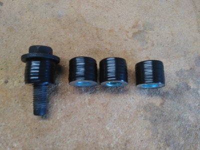

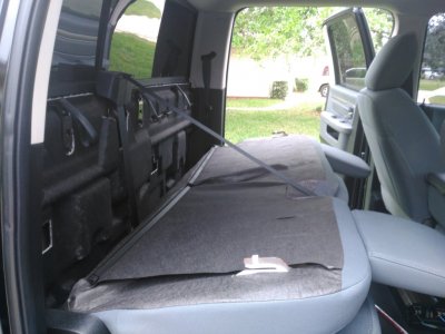

Got an itch to do a mod this weekend, couldn't help myself! Raised rear seat and now have the folding option and the seat finally sits flat again. Everything works flawlessly. Next is to move the amps behind the seat.
Was a piece of cake. I spent longer driving to Lowes and hunting through their specialty section for the washers than doing the install. Lol..

How many washers in each stack?
I Love My 2018 RAM 2500HD 4x4 6.4L
MarshRam
MarshRam
May 24, 2017
2,256
1,479
Florida
2014 SLT 4x4, 2012 ST
8 washers. The stack should measure 3/4". The hole in the washer needs to be 1/2". I used these from the specialty drawers.
