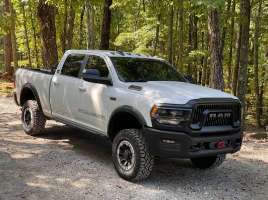

How's the ride quality work updated suspension on road? It looks like stock tires still in this picture?
David Ware
David Ware
Jan 4, 2019
52
62
Augusta, GA
6.4L hemi
Its not game-changing by any means, but it is an improvement over stock. This is the only true way to level a truck and get the benefit of a better ride quality..spacers shouldn't even be considered. I am overall happy with the setup, but if Kings weren't 9-11 months out on wait times I would have those instead. The ATS Fox steering stabilizer is top-notch, I recommend one of these to anyone going bigger than stock tires. And yes, still stock tires for the time being...it will have to wait until after we move into our new house next month.

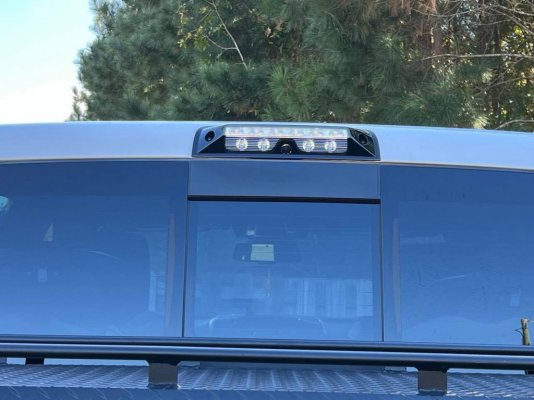

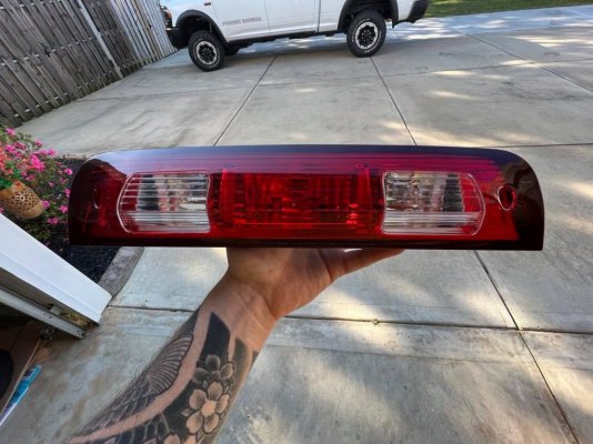

The new bed light is in! I went with the factory MOPAR CHMSL (Part #: 68523968AA) from Moparfactoryparts.com for $180. You can't beat the price, considering what all comes with it compared to other aftermarket options. I originally went with a smoked RECON LED third brake light and after the first rainstorm, my ENTIRE back seat and headliner were soaked. It was a nightmare getting all the water out and everything dry.
So for the same price, I picked up the factory smoked MOPAR option to match the white/black theme of the truck. I'll eventually run the camera cable since it is not already pre-ran, this may be my winter project..but for now, it is a huge upgrade over the factory red halogen third brake light which doesn't match anything on the anniversary trucks. Additionally, the third brake light matches the bed lights and the light throw is so much better at night.

I have that light, it’s blinding at night.

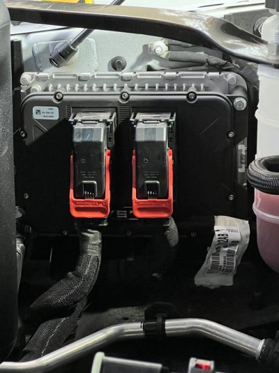

Im waiting for the tuner conversation to start.
David Ware
David Ware
Jan 4, 2019
52
62
Augusta, GA
6.4L hemi
Its your lucky night ;) As for the tuner, I skimped out and went with what everyone else is doing and picked up an Edge Pulsar. If I ever decide to Cam the truck or do some head work I may go with a custom tuner. There just isn't enough info on the forums to persuade me to a custom tune for what few bolt-ons I do have.
The Edge Pulsar was easy to install, it should take a novice person no more than 20 mins to hook up. The power levels are surprisingly beefy...I am coming from a 2019 Raptor and I feel that tune 6, Performance tow w/o MDS, feels as strong as my stock raptor. Tune 8 will be perfect for when I slap 37's on the truck, for now it is just too touchy and gets very spin happy on the stock 33's. Also it gives you the ability to adjust gear ratios and tire sizes if you every decide to change things up. It doesn't replace a custom tune, but after having plenty of vehicles with custom tunes this out of the box tuning is not bad at all.
