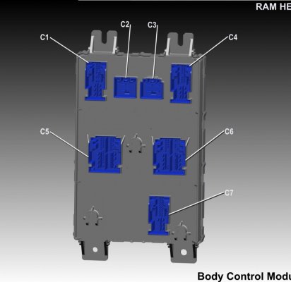

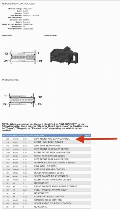

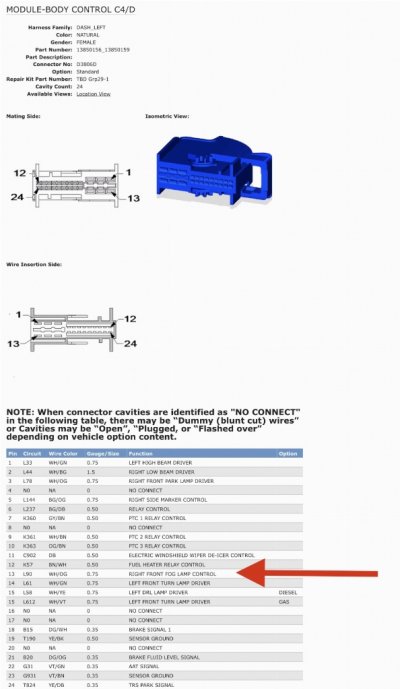

If that connector is not there, then you’ll have to run your own wires for the right and left fog lamp signals straight to the BCM, and pin them into the right spots on the connectors. The two fog light ground wires just get grounded to metal. The BCM is up behind the dash above the brake pedal. Here’s the layout for it looking at it mounted to the firewall- QotiFuC.jpg
These are the two connectors that have the fog lamp circuits- fKCR4Zp.jpg T3dockU.jpg

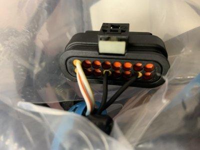

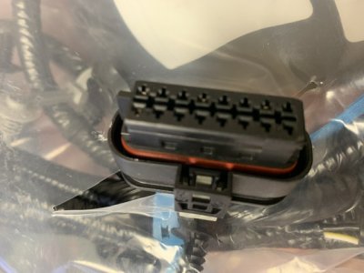

I just got my OEM harness, part #68377331AD, from AllMoparParts. Note that the fog light-only harness has just 4 wires and pins. The others are sealed off from weather - a great idea! You can see right off that pins 8 and 16 contain the colored (hot) wires that power each of the two fog lights. Interesting that they run ther bulb grounds all the way back instead of a chassis ground up front.
Pin #1 (empty) would be the bottom right in this view. Working right to left: Pins 2 and 5 carry ground and Pin 8 carries a signal. Right above it, Pin 16 carries the other signal (hot to bulb).

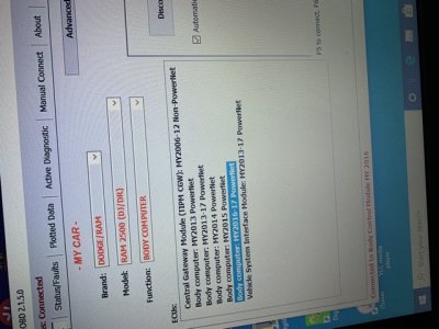

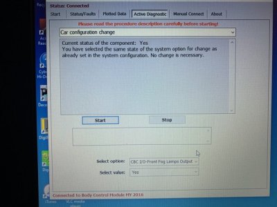

Got the fog lights coded. Now to finish wiring them into the body control module.

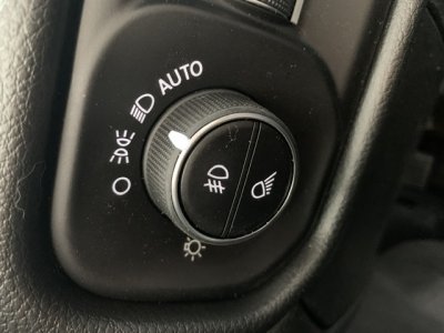

Switch: Headlamp is p/n 68156061AD retails for $39.95. You need this because it has both the bed light button and the fog light button embedded in the center of it. The original switch in my truck has the entire center of one button only for the bed light - which is the center light up high on the cab as part of the CHMSL. My truck doesn’t have the optional “cargo lights” which are back on the sides of the bed by the tailgate.

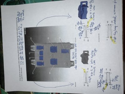

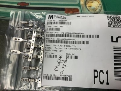

Ok, I’ve run the wiring from the BCM through the firewall and up to the fog light harness I installed already. After trying several of the connectors I have on hand, none will slide all the way into the BCM connectors C1 and C4. Those are shown as 0.75 gauge/size on the diagrams above. A tip, it is a bit easier to unplug C1 and C4 if you first take out the knee panel under the steering wheel. Once C1 and C4 are out, you slide a thin jewelers screwdriver alongside a spot to lift a small tab and then withdraw the actual wire connector from inside the piece that clamps it down into the BCM.
Is there a Mopar or aftermarket part # to get some of these? Basically the metal clips that you crimp onto your stripped wire and then slide/snap into the open spots as per above.
Here’s the terminals for the fog lamp circuits in the BCM connectors- https://www.mouser.com/ProductDetai...8oGXoX7vSDezsCEh/TeFPHxy2z8Kh8Nv44XLlKWlO4Q==

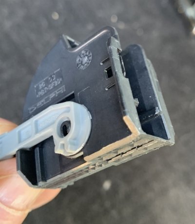

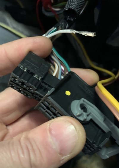

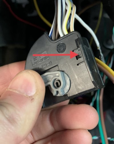

Just to help people visualize what you had to do, since I just got done swapping in a BCM for a project I’m doing, here’s the C1 connector, and how to take it apart to add or remove wires. You’ll pry up here, and slide the wires and terminal block out of the latching hood shell- mfmzOOM.jpg QbC6LHq.jpg Tb7lOhS.jpg
Then, you just insert a wire with terminal in the appropriate position, or to remove a wire, you depress the tab shown, and pull the wire straight out- UjHm4KR.jpg

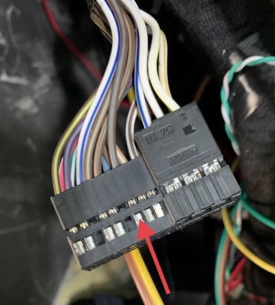

And here is a photo that shows the 0.75 connectors used for the 6 big wires, to the right in your last photo. One of these in each of C1 and C4 is open, awaiting a wire with the part below crimped on.

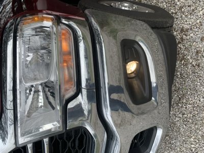

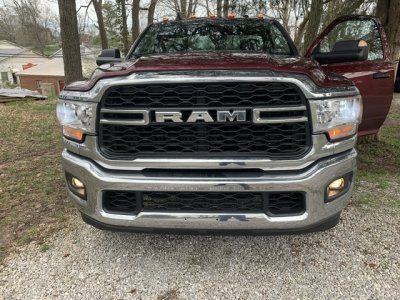

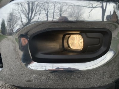

Mission Accomplished.
Following the posts above, I crimped these connectors on my wires. Then, working one at a time, I withdrew the C1 and C4 from the BCM, carefully unclipped and slid the connector covers off, and inserted one wire into each exposed opening. Works like a charm. Fog lights are on/off with the button and they can work with both the low beams or just the parking lights. Nice to have the OEM retrofit. Now maybe I will swap in a pair of the Bright Earth bulbs - same part # as the low beams.

- How difficult was it to swap out the light switch?
Easy - it pulls out from the front if you use a plastic pry tool.
