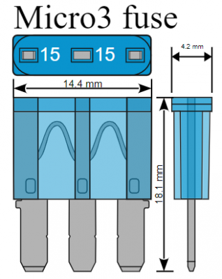

Micro3 Fuse:
Micro3 fuses are basically a double Micro2 fuse. They are easily identified because they are longer and have three prongs. These are used only in the Internal Fuse Panel. They're available in current ratings of 5 to 15 Amperes. The dimensions of the Micro 3 Fuse are 14.4mm wide, 181mm tall and 4.2mm thick.
The Micro 3 Fuse is designed to protect 2 different output circuits from a single power source. Power flows into the fuse via the middle prong and out via the 2 outside prongs. The fuse ampere rating applies to both output circuits.
RAM also used some Micro3 fuse sockets to give owners a choice of circuits. For example, Fuse 54 is a Micro2 style fuse plugged into a Micro3 socket. The "A" side (to the left) is used for constant power whereas the "B" side (to the right) is used for IGN power. This is why there is a Fuse 54A and 54B, although you can only select one side or the other. I don't know if this is a common usage of Micro3 sockets with Micro2 fuses or if RAM is being clever.

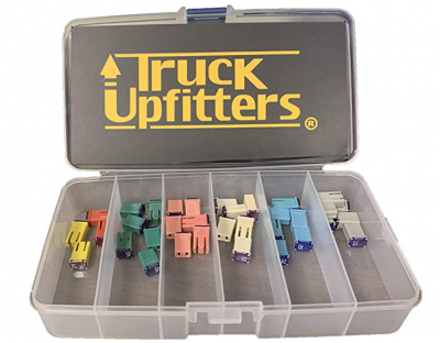

MCASE Unslotted and MCASE+ slotted:
These were the hardest to find, especially the MCASE+ slotted, but this handy kit contains both:
