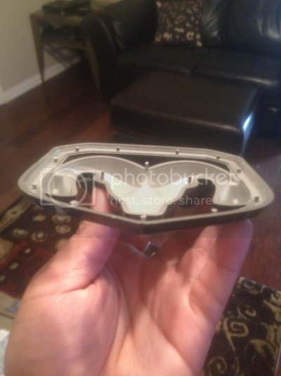

Sorry if this is a repost... I only found one other thread and the pictures didn't do justice.
Pretty simple... The white circles/dots are a glue/adhesive of some type. Pop these off. All of them. I used a pocket knife to work around the circles.
Once the dots are off, insert something flat into the sides and pry gently, as to not break any of the plastic rods.
Here it is removed, and afterwards, side by side

With all the stuff you've been doing, I had to try to beat you to it! Lol.
I used epoxy/ a bumper repair kit to put it back together. Fyi. I'm sure there's other options, but wanted to make sure it was staying. Already had the kit cause I filled in holes where they drilled my front license plate. Let me know if you want part number. 6 bucks on amazon plus free shipping from amazon plus

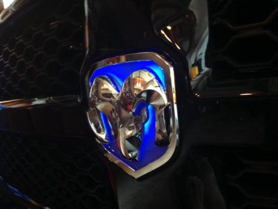

Got this done the other week. It is mounted in the grill now but not hooked up to running light circuit yet. Working on another project for my turn bulbs that are not ready yet. This will get hooked up when I get hat project done. ImageUploadedByTapatalk1405563750.105613.jpg
I can not take credit for it. Saw the thread in here but it had some broken links for pics and I managed to figure it out.
I was also thinking about lighting up rear emblem in some manner. Doing something like this or lighting the eyes like the previous poster had mentioned. :undecided

Ummm sort of. The other pics worked with the exception of where to mount the LED strips. So that part I figured out on my own and took a pic of. ImageUploadedByTapatalk1405602398.677958.jpg
So the black marker is inside the emblem and you can not see it from the outside. It was a reference for me to place the LEDs in the correct spot. Used some small strips of 3M bodybuilding tape all the way around the badge and put these 2 pieces together. I then used some bigger pieces to put the whole piece back on the grill.

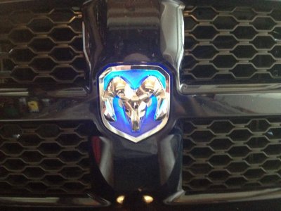

Fire, have a pic attached to the grill?
Here it is. Attached to grill looks basically the same stock emblem. Slightly lighter background but hardly noticeable. ImageUploadedByTapatalk1405969423.514127.jpg
And here it lit up. It's temporarily attached to battery just for these pics. Still working on final attachment for lighting.
Again I do not take credit for this. It's from another member on this site.
