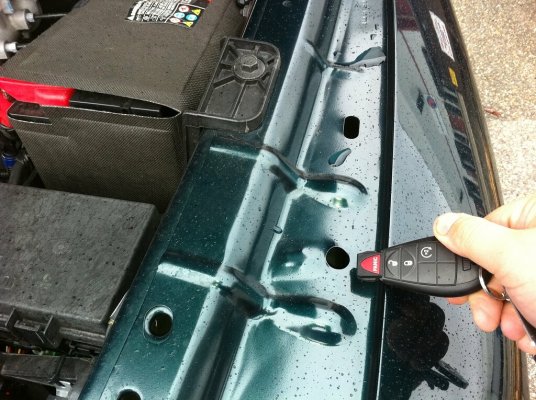

There is a hole in the fender, next to the key here:

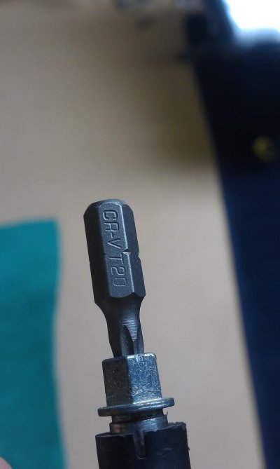

You'll need a ratchet, an extension and either a 7MM or T20 bit.
Here is what the adjuster looks like:
couldn't get the camera to focus (stupid phone), but this is a 7MM
Crank away! Clockwise = up!
