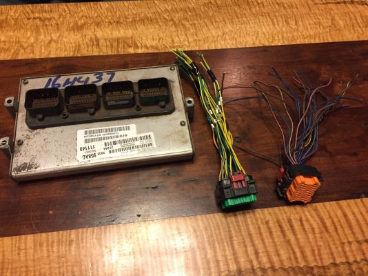

Well I'm gonna start this swap. After a few weeks of searching I ordered (what I sure hope lol) is the right pcm from a junkyard in Texas. Found some extra plugs at a local scrapyard. Definitely nervous about doing this, hope everything goes smoothly 37fa9894aad75d2ef4248a4b2d4f184d.jpg

If you're that nervous about it, hotwireauto has already done these harness modifications successfully.

I'm not nervous about the wiring (I'm an electrician by trade) and I got all the wires matched from the pinouts. I'm just nervous about potential vin mismatches and getting my tuner to recognize everything once I finish. It's my daily so I don't want to be out of a truck for a week waiting on stuff. We'll see I guess

Matching everything right, the pcm programming and converting the coil pack connectors to the newer style is why I have been seriously considering sending it to them. They actually take your 03 harness and alter it, plus program the pcm.
