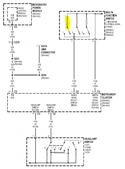

The Instrument Cluster monitors the headlamp
and multifunction switch operation. When the headlamp
switch is rotated to the parking lamp or On
position, the Instrument Cluster sends a J1850 message
to the Front Control Module (which is mated to
the power distribution center to become the Integrated
Control Module) to illuminate the appropriate
bulbs. When the multifunction switch is activated to
the optical horn (flash to pass) or high beam position, the Instrument
Cluster illuminates the high beam indicator
and sends a J1850 message to the Front Control
Module to illuminate the appropriate bulbs.
Sounds like your problem is in the "cough" instrument cluster, or the cluster thinks there is a problem with your low beams.
So when you try to go to your low beams, will your brites/brights go off?

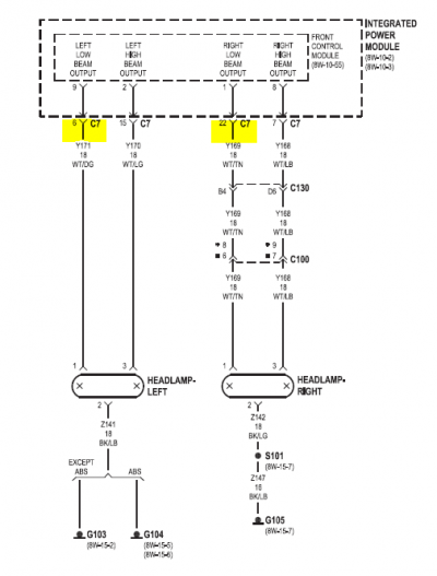

I'm looking at the wiring diagram now for a relay.

So if your brites go out when you pull back on the stalk, and your low beams just don't come on, I'm guessing the stalk is OK.
Have you tried cleaning C7 with some de-oxit, or tried pulling C7 and jumping 12 volts directly to pins 6 and 22 to see if your low beams come on? And these are not LED bulbs correct?
